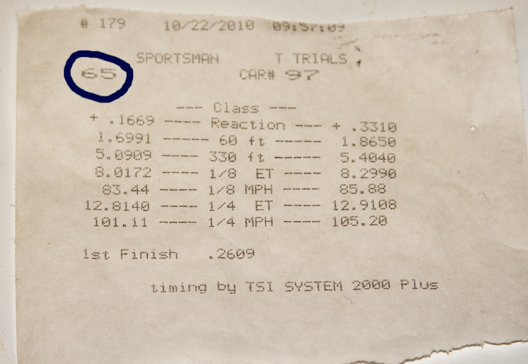

I can't believe he's down to 1.69 60'
That's crazy. Must be doing some hefty boosted launches for those numbers. I'd love to see a few videos of his truck running down the track. More recent ones anyway.
That is crazy, i run those with my race car (well, really its a street/strip car) not my tow truck!

Old but, best 60' . . . . . .

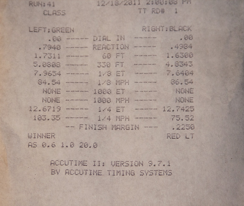

Best 1/4th ET . . ..

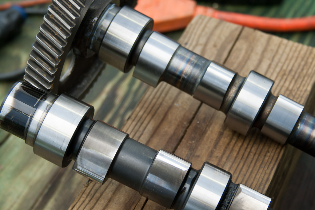

1. Why the 188/220 steel cam over the cast? doesn't that require block bushings?

2. I had no idea you were running those times... that's a nasty 1/4 mile time for a first gen.

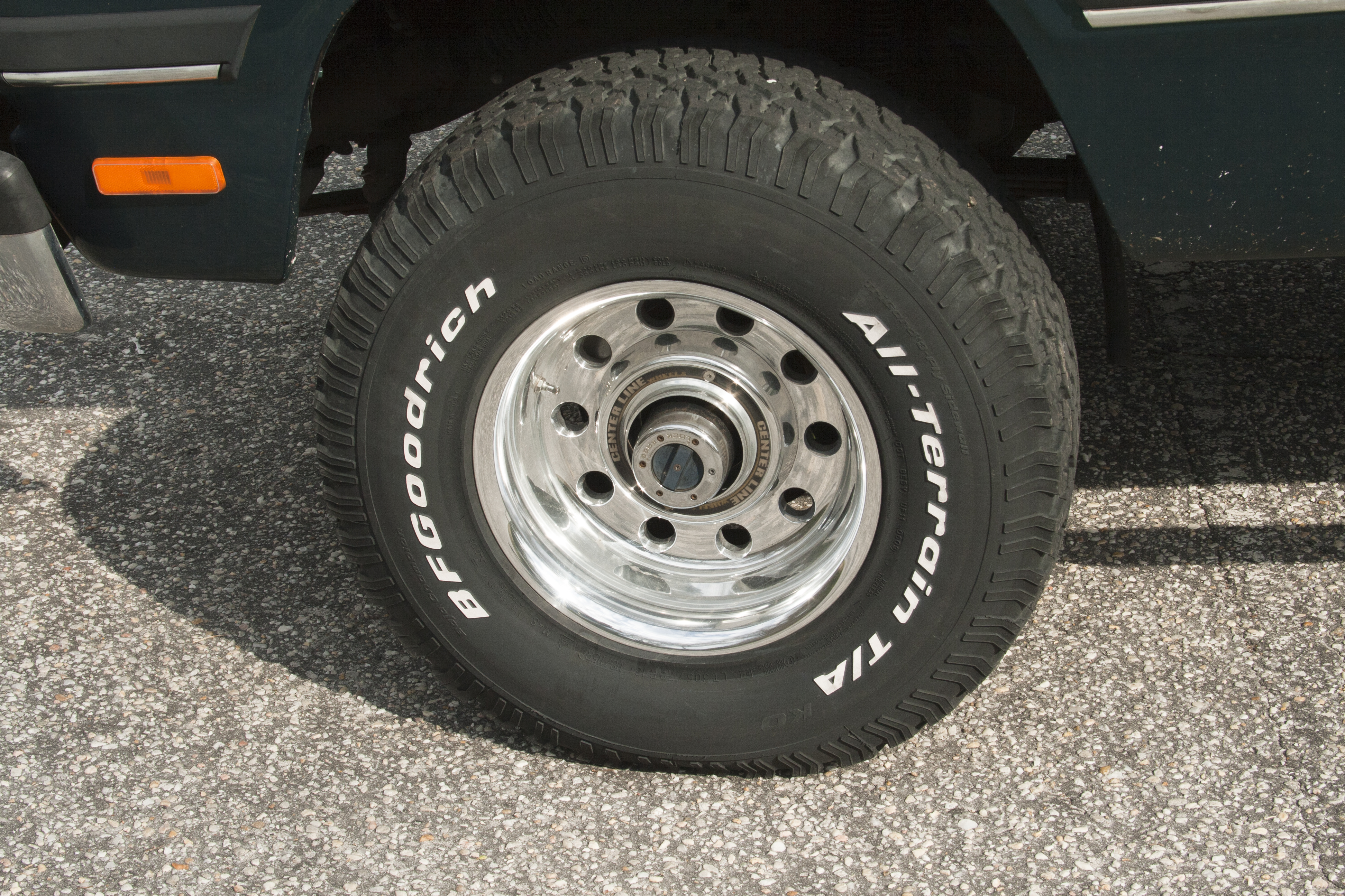

What size tire are you running on that truck?
According to Zach, "Block bushings are required when running high rpms and high valve spring pressures". Apparently such is not applicable with the relatively low revving VE fueled Cummins. I'm running his basic HD springs.
The steel 188/220 (top) and his initial 181/210 (lower) . . .
33" BFG All Terrain Radials.

That's why I was curious. I didn't think we (or you even) would run high enough rpms and spring pressures to warrant the steel cam. That's more of a Sled pulling cam where they're running 5k rpm amd dual springs was my take on it.
