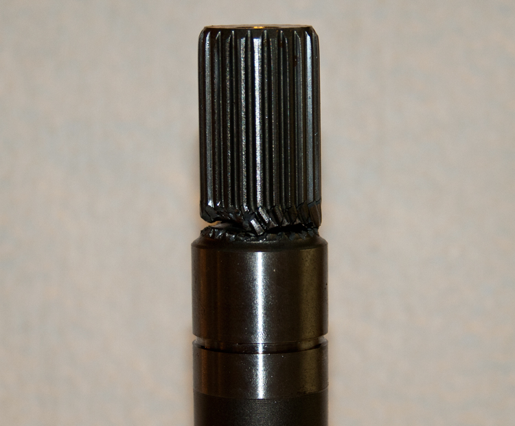

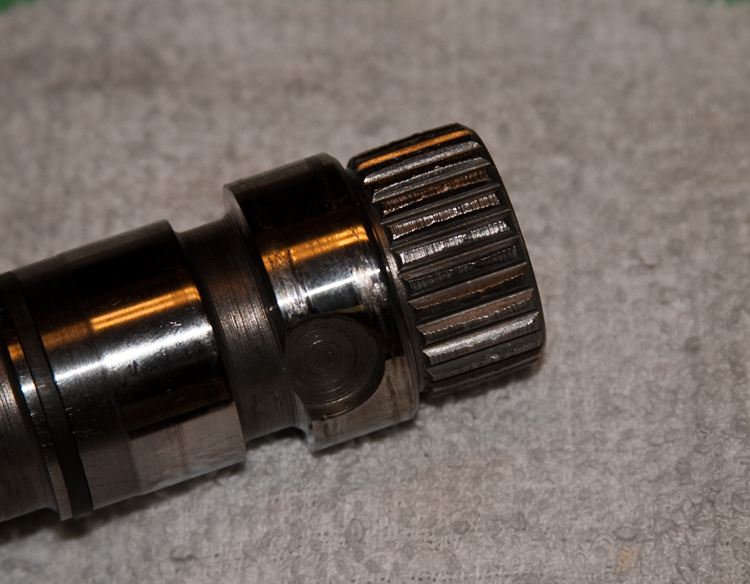

Just enough to realize the input-shaft assembly's weakest point. From an unknown manufacturing flaw/defect, worn components, to cumulative fatigue. How many miles are on your stock/OEM shaft?
Some just plain twist the thing in two. I stripped the splines between the shaft and it's associated clutch-drum.
This occurred as I was "Scuffing the tires" on the return road prior to getting on the track. Never made it to the track. The splines passed a recent FSM instructed inspection. Cumulative fatigue.

Boosted launches busts stuff. - Ya gotta pay to play.

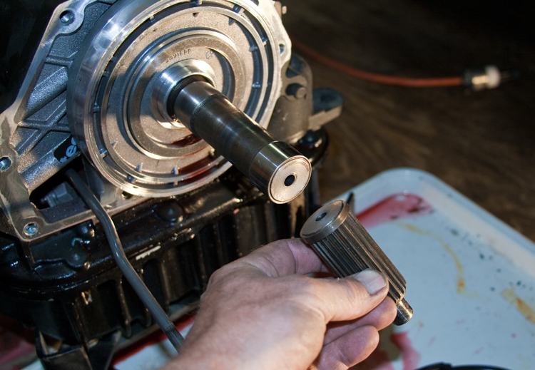

I busted the intermediate-shaft well before I busted the input.

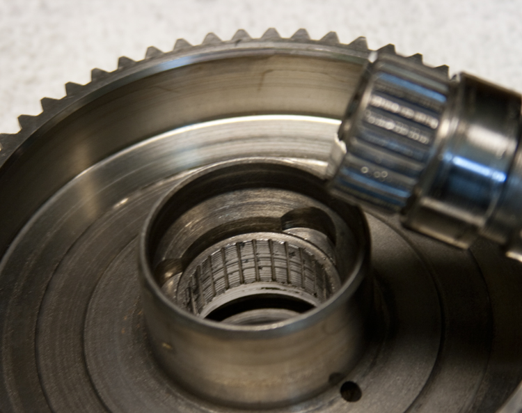

I can't remember when I busted the output-shaft . . .
