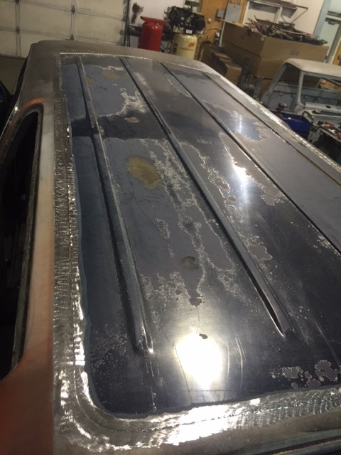

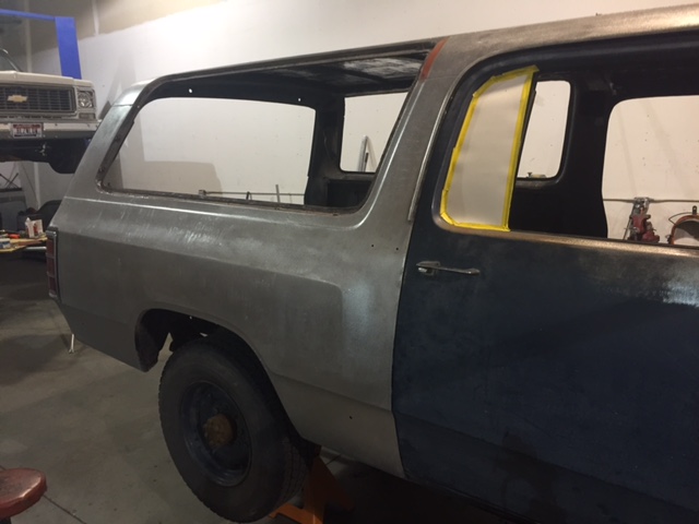

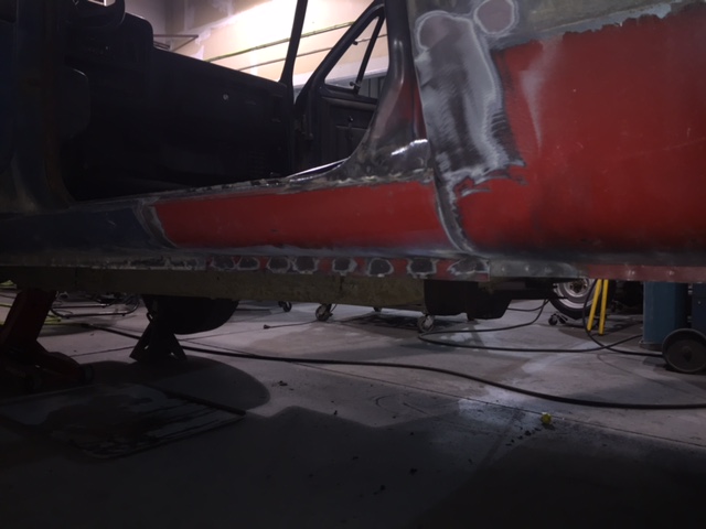

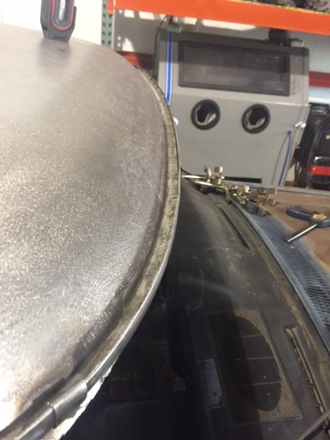

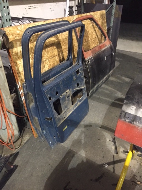

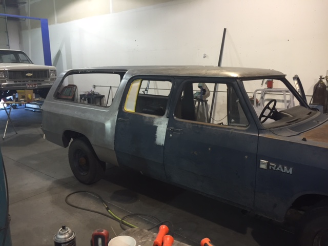

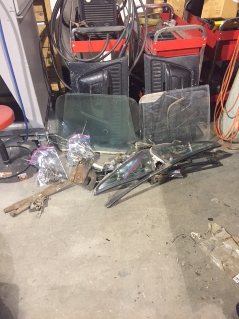

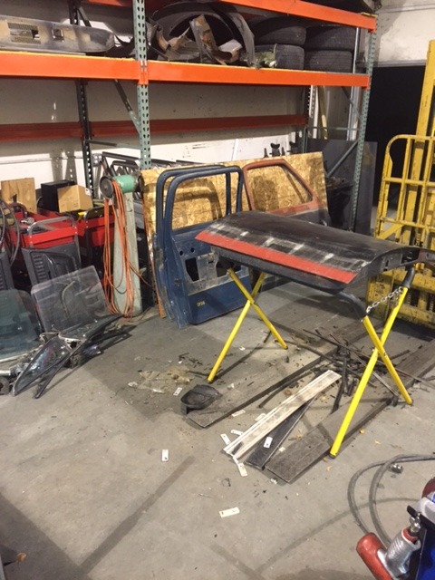

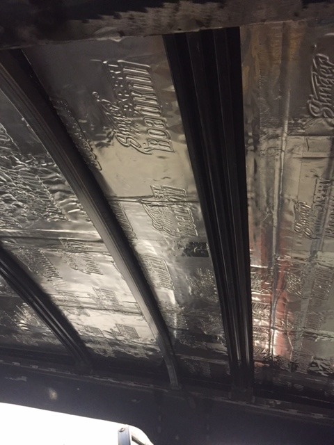

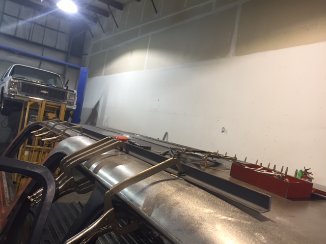

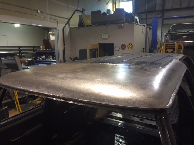

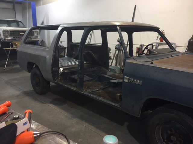

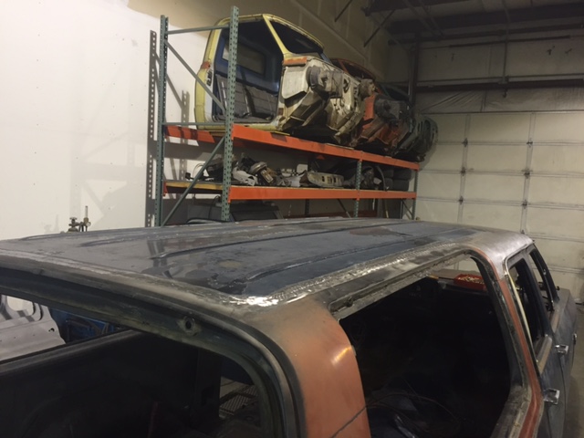

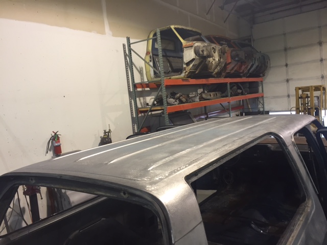

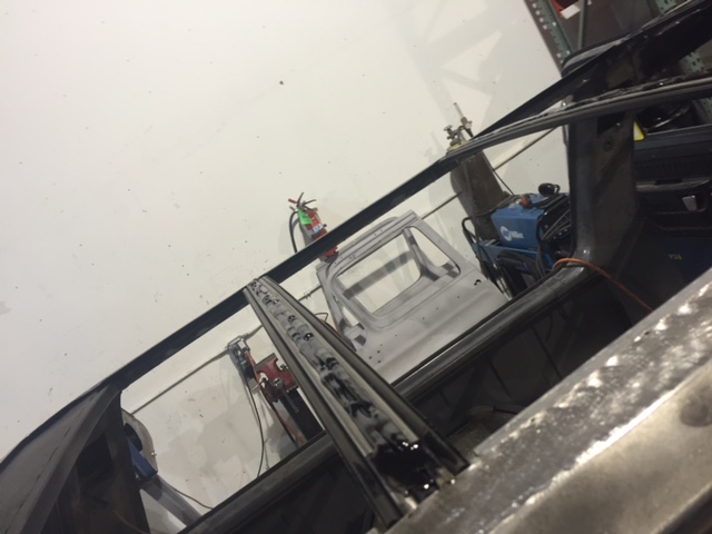

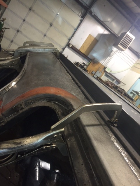

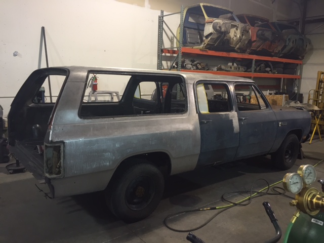

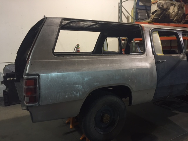

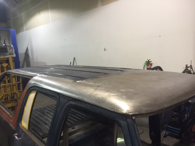

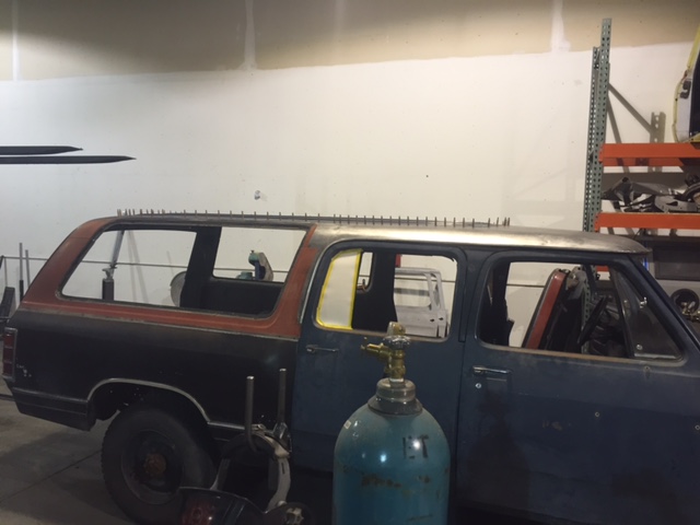

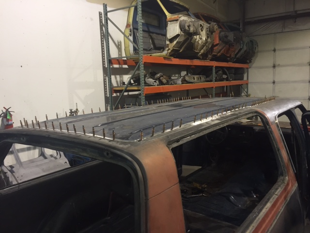

Front section is welded down and rear is in place. Final welding is taking place today. 2nd fuel filler door and rockers should be done this week as well. Then the body is off to be rotisserie media blasted, under coated and epoxy primed.

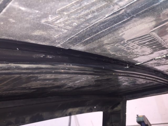

Everything that is non accessible gets treated with POR 15 then dyna matted

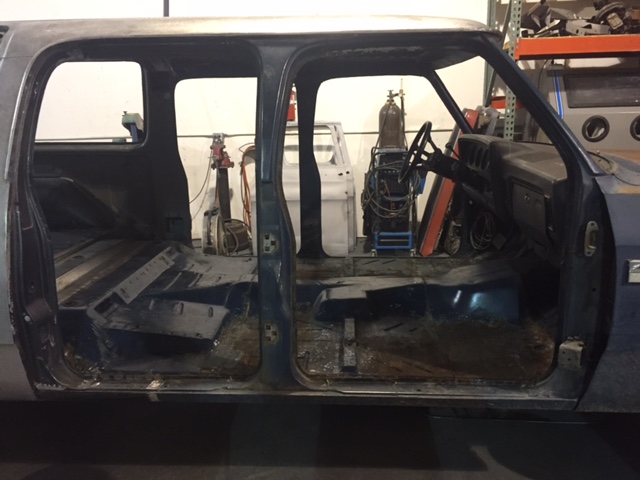

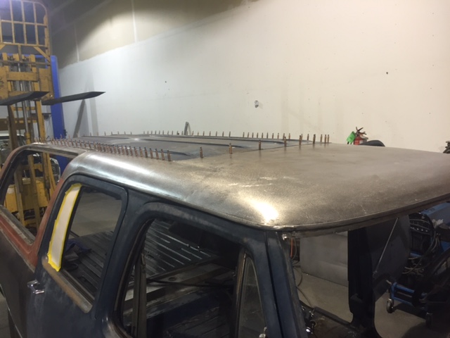

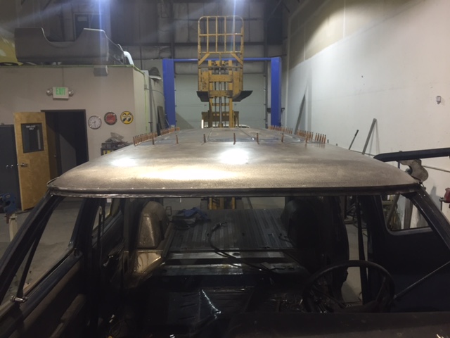

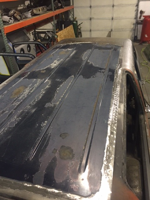

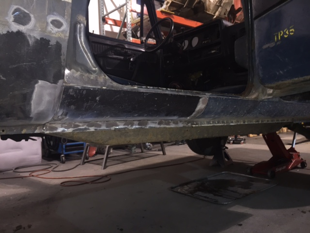

The roof is now done, rockers are done, body is getting stripped. It goes for blasting, under coating and epoxy prime next week.
