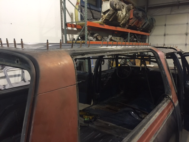

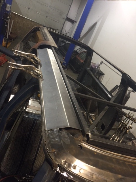

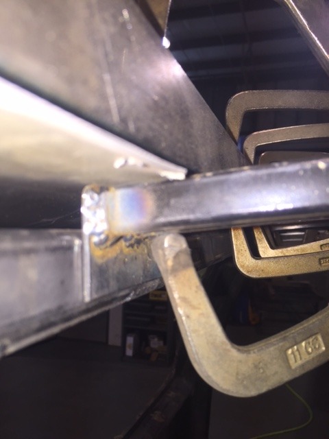

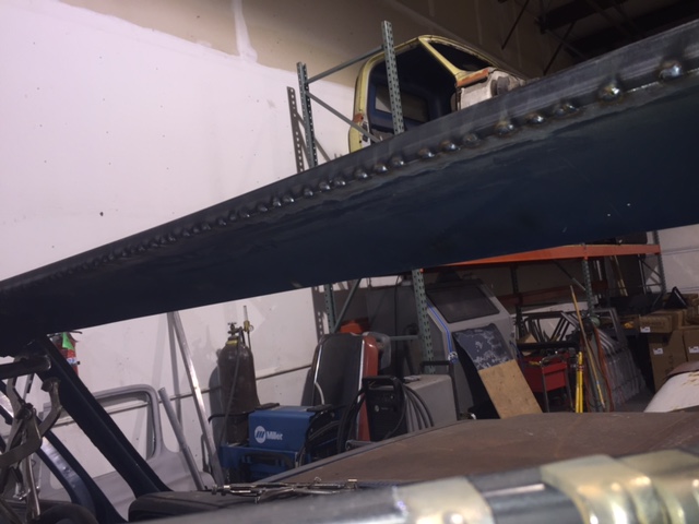

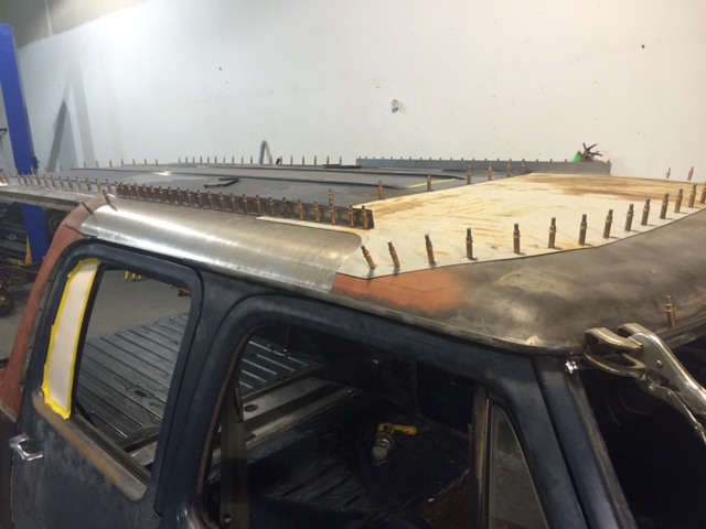

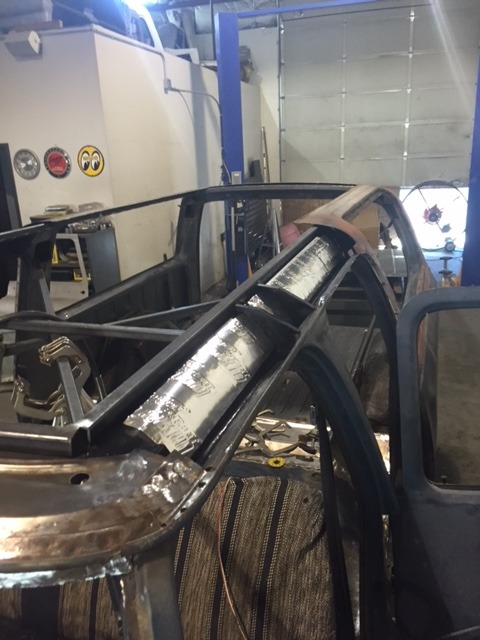

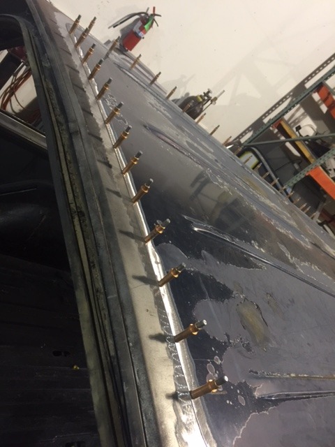

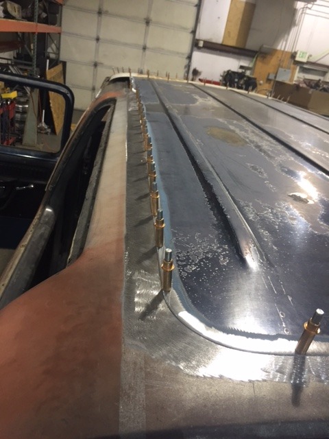

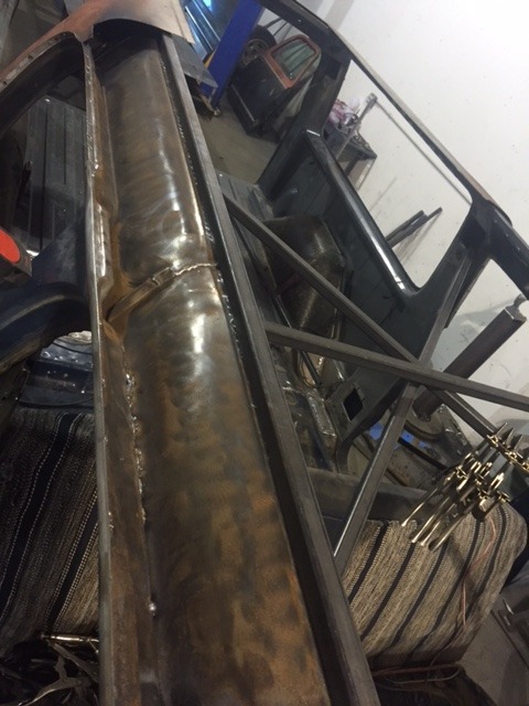

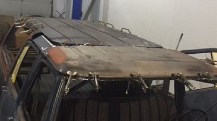

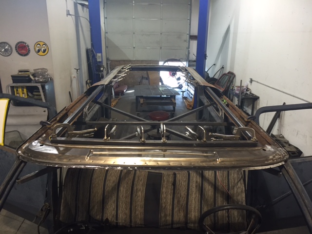

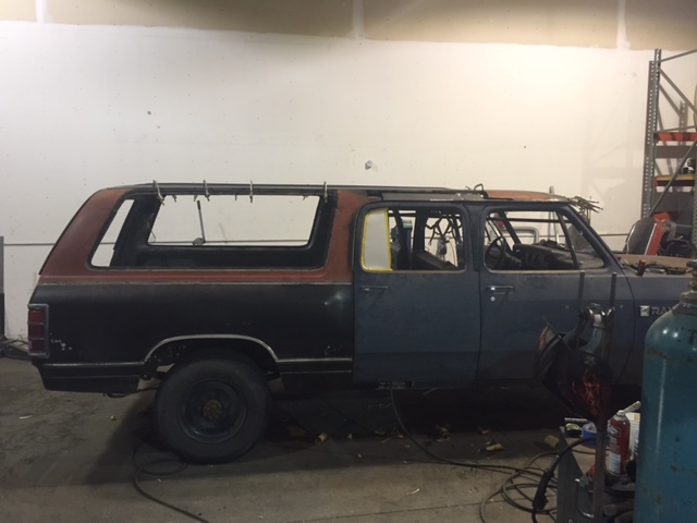

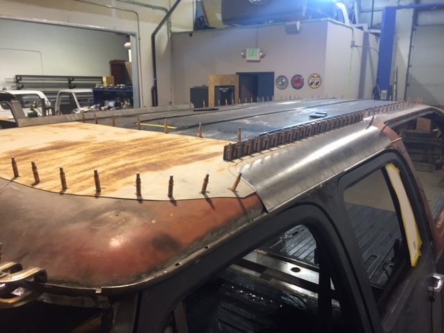

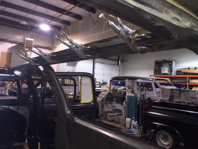

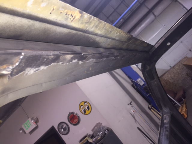

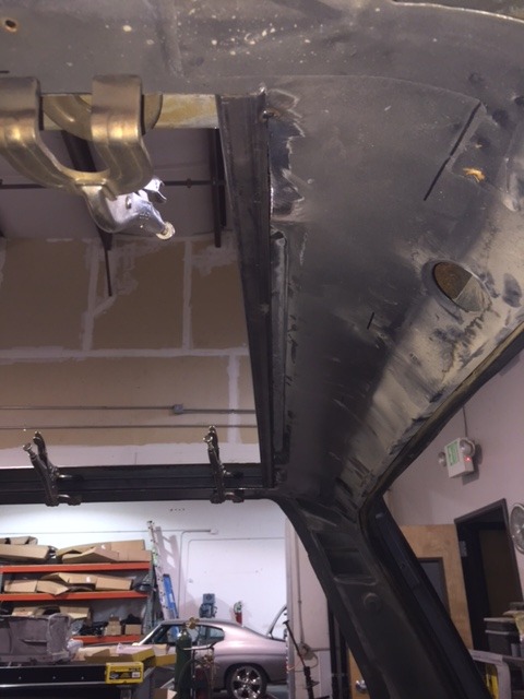

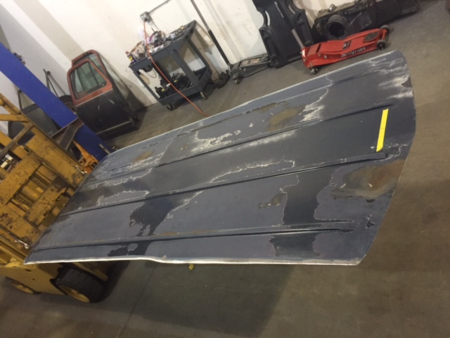

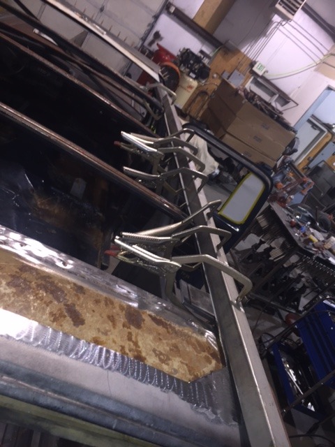

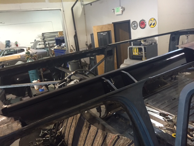

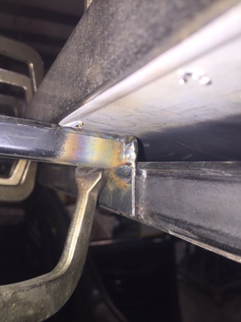

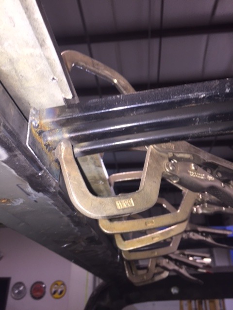

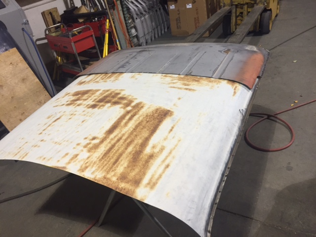

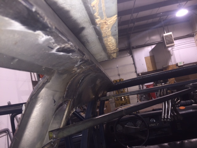

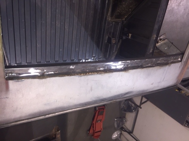

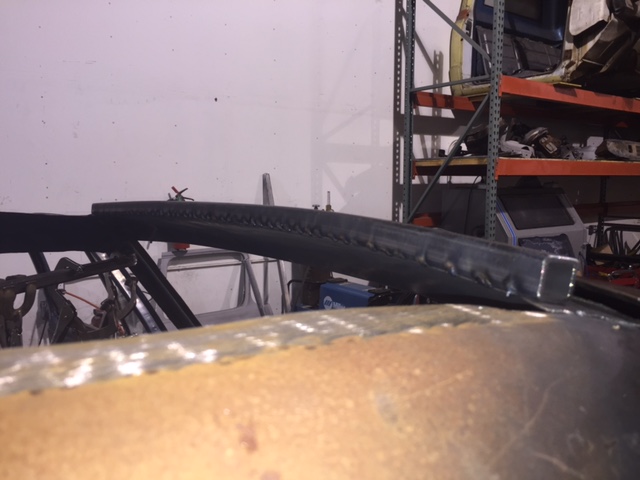

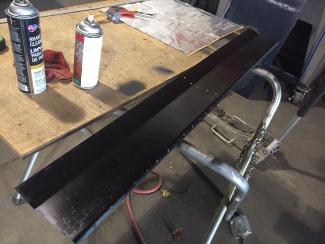

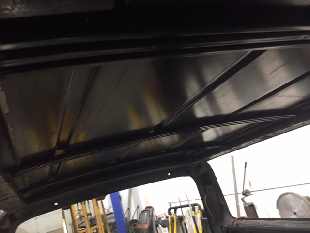

Roof structure progressing Name:  E88B5DF2-52EA-4863-A434-0F2FEB708629.jpg

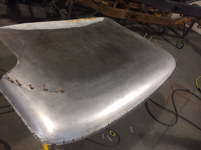

Old Oct 7, 2016 | 02:44 PM
  #49

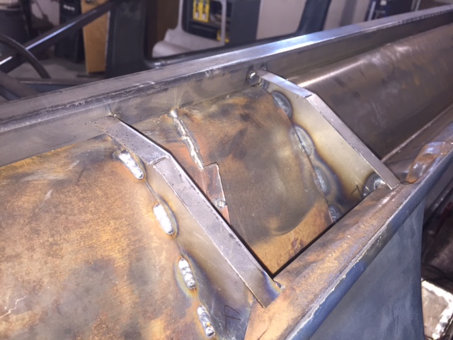

That looks like some pretty stout box tubing! definitely going to be strong as a complete body once done!
Old Oct 7, 2016 | 06:35 PM
  #50
I read here, from one of you guys, that cracking was an issue on this conversion. I guess he's eliminating that possibility.
Is there room for a sun roof in this ? Imagine that big for a sun roof ? Your entire family, and local softball team could stand inside during parades
Old Oct 7, 2016 | 06:58 PM
  #51
gyman98's Avatar
Posts: 1,437
Likes: 208
From: Saskatchewan
Yes this roof won't be cracking or coming apart at the joint. No "oil canning" of the roof either

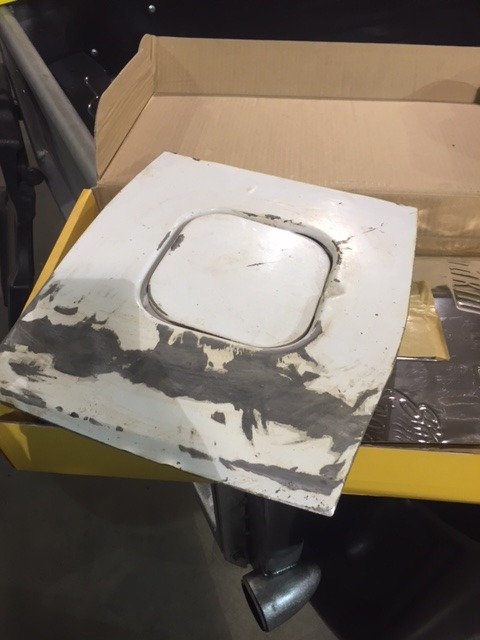

  #53

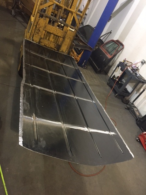

Just curious,
What is the game plan for transition between the different ribs in the roof ? A central bar in which they all meet ?
Tremendous amount of work to do this conversion. Are you doing any of it yourself, or is it all on them ?

Man, any idea how much weight you are adding by beefing up the roof? Just curious is all, looks like a lot of metal. Will be stout when done.

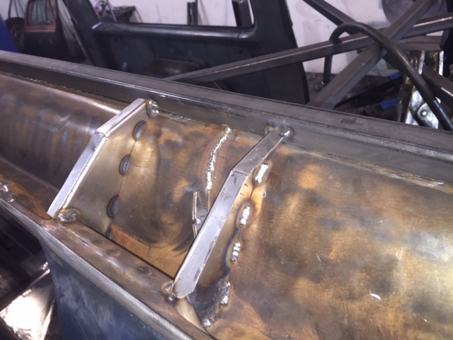

They have a lot of falling tree branches up there.
I like the reinforcement points between the doors. Nice touch, as it will distribute torque load of the hinged door, and "wife slamming the door" load of the striker side
I would love to be there looking at that being built. Anything fabrication linked is like truck pourn to me....

Originally Posted by NJTman
Just curious,

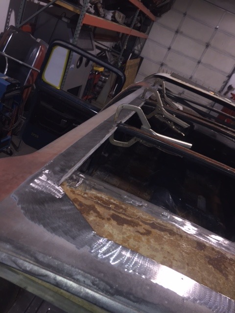

The suburban roof bows are going to be used and the joint will be on top of one of the bows and stitched together
He is going to do all the metal conversion work, I'll probably get it blasted somewhere and epoxy primed. After that I'll be doing the 4wd, diesel and rest of the drivetrain conversion, wiring harness, suspension, interior etc

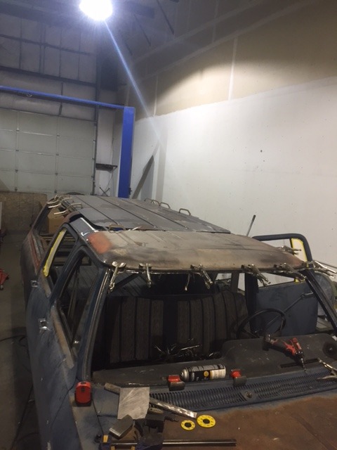

Old Oct 26, 2016 | 12:22 PM
  #60
gyman98's Avatar
Posts: 1,437
Likes: 208
From: Saskatchewan

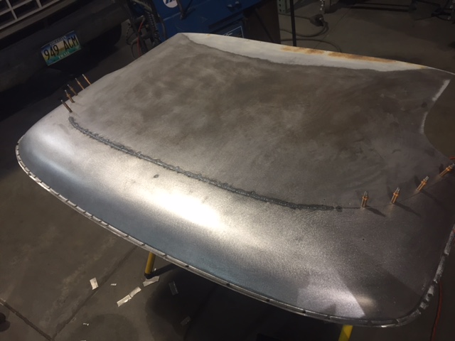

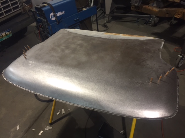

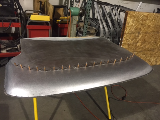

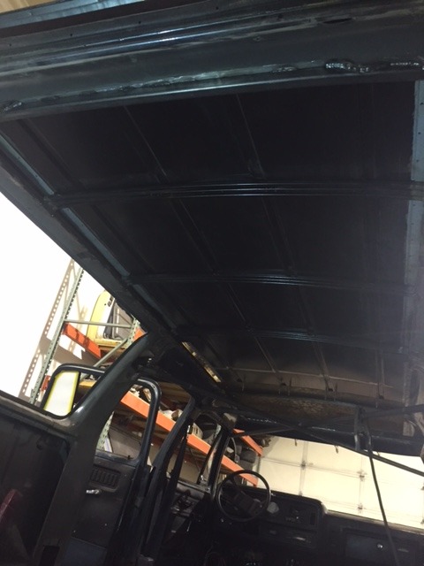

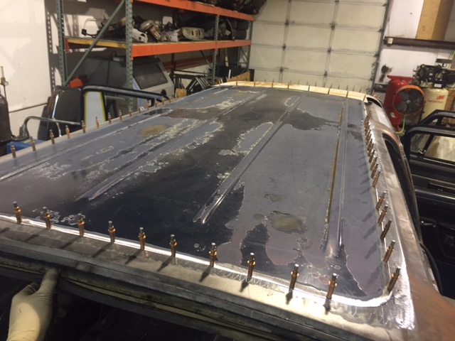

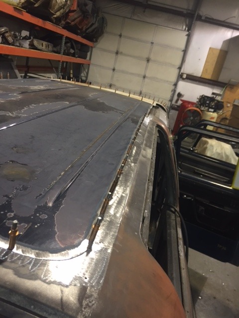

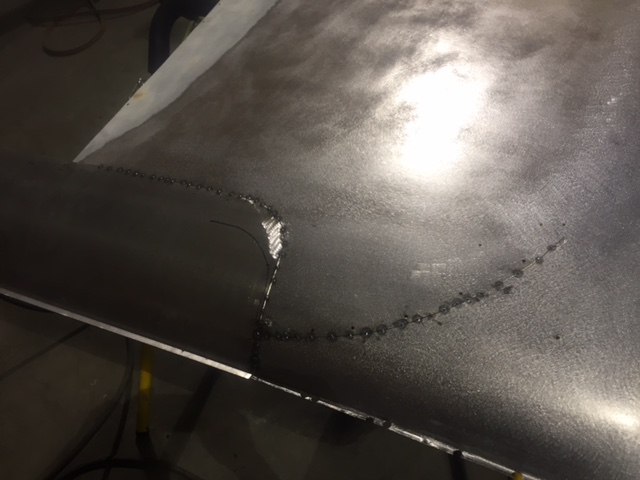

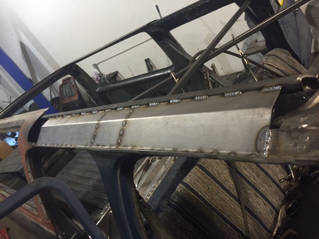

Front roof is coming together nicely next will be installing on the truck and seaming it into the rear.
