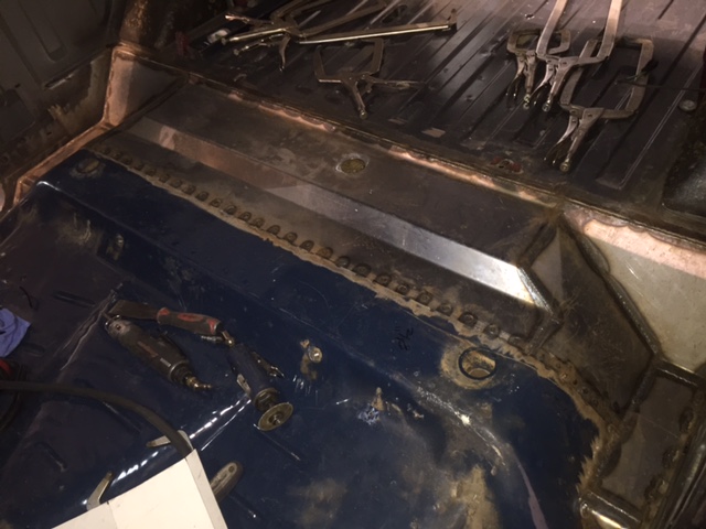

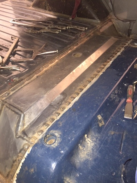

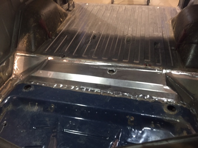

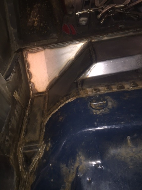

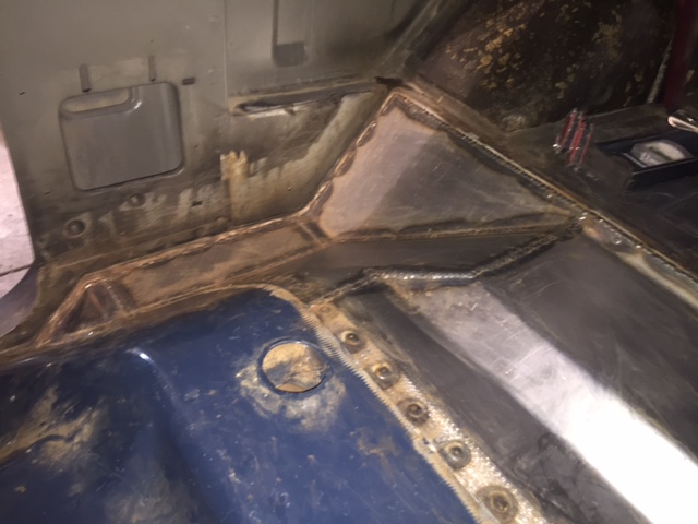

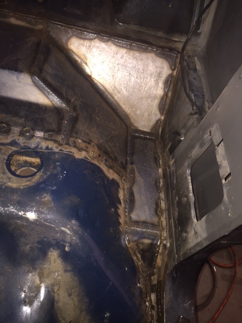

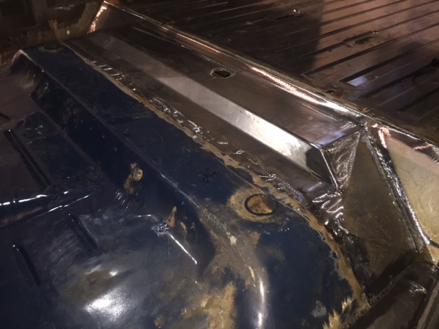

Welds look beautiful! Forgotten art nowadays!

And just like that it's almost done.... The shop is doing some good work there....

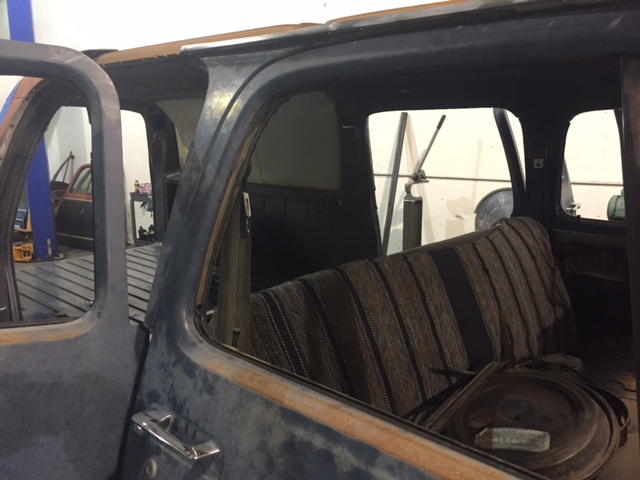

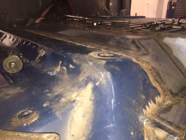

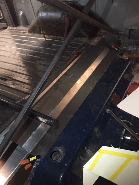

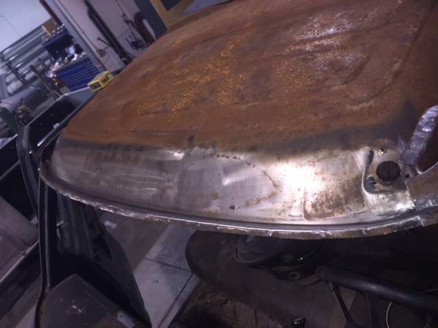

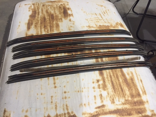

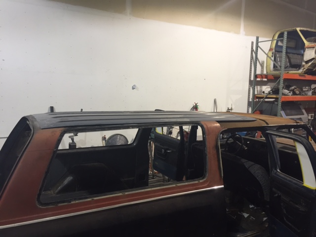

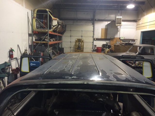

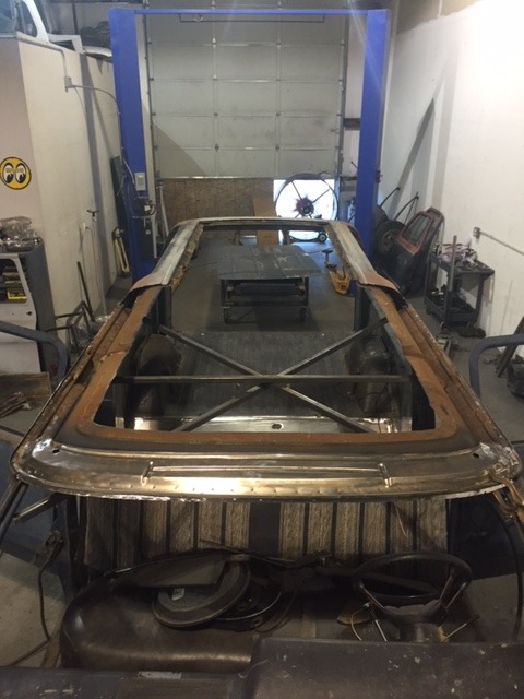

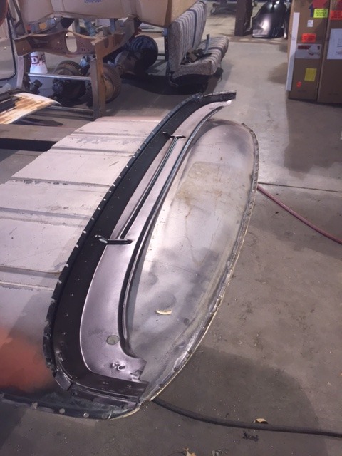

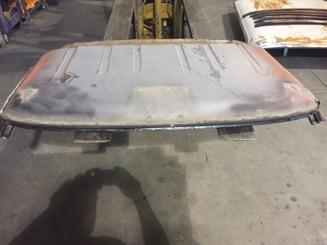

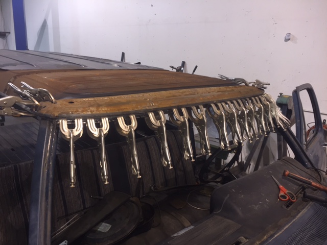

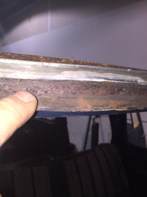

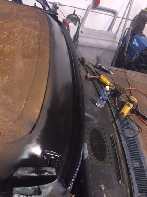

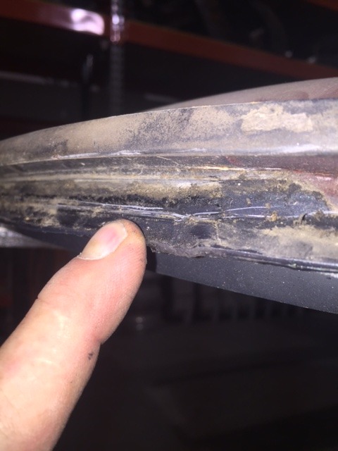

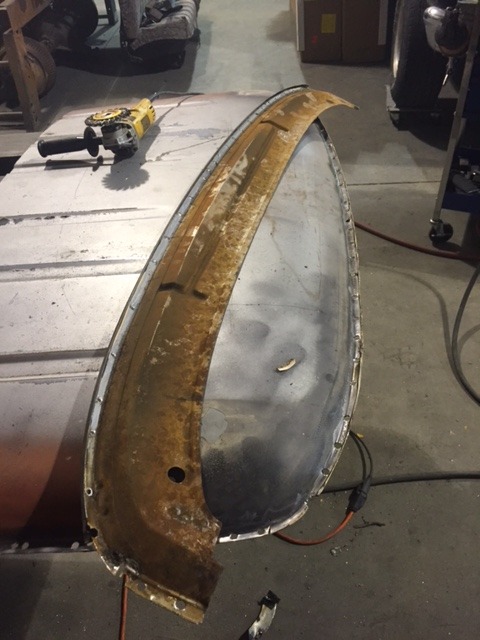

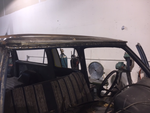

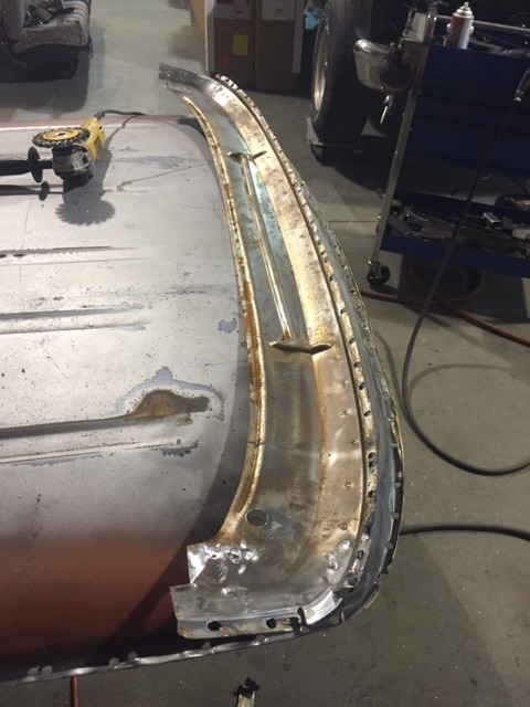

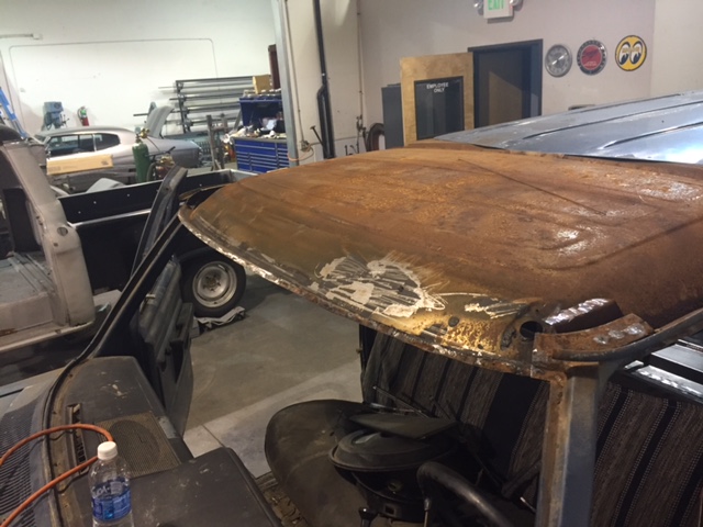

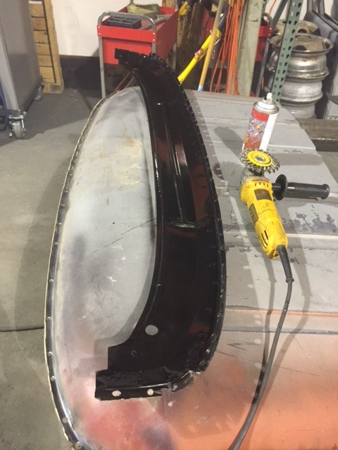

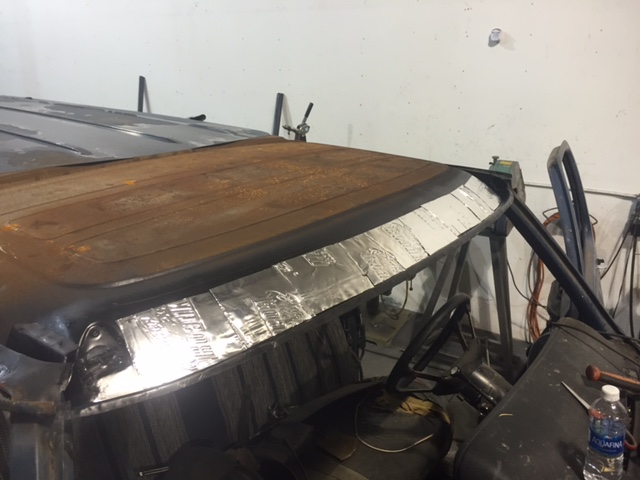

The suburban roof being test fitted. The rusty crew cab roof area which will be removed and replaced with the rust free Ramcharger roof

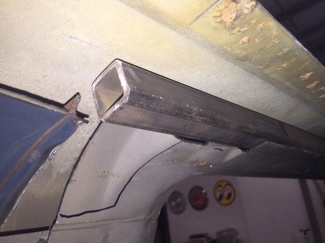

Old Oct 4, 2016 | 12:41 PM
  #37
The RC roof has ribs and in it, compared to the smooth crewcab roof, and then the extended ribs from the suburban roof skin....have they mentioned how they are going to combine the two?
Again looking really good. What year suburban roof?
Old Oct 4, 2016 | 08:17 PM
  #38
Uh, holy...... WOW !
Old Oct 4, 2016 | 10:28 PM
  #39
gyman98's Avatar
Posts: 1,437
Likes: 208
From: Saskatchewan
The roof structure is going to be built out of square tube and the suburban roof bows. Get rid of the terrible sandwich design dodge had.
I'm not sure on the year of the suburban but it was the 73-91 body style

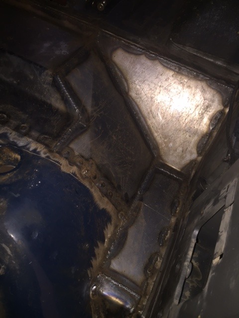

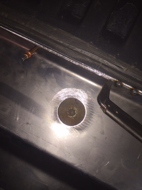

That is one heck of a shop! How are you doing those spot welds!?!
McIver custom fabrication are the ones doing the work at this point, I believe he is drilling through to the structure beneath and then plug welding. Strongest it can be

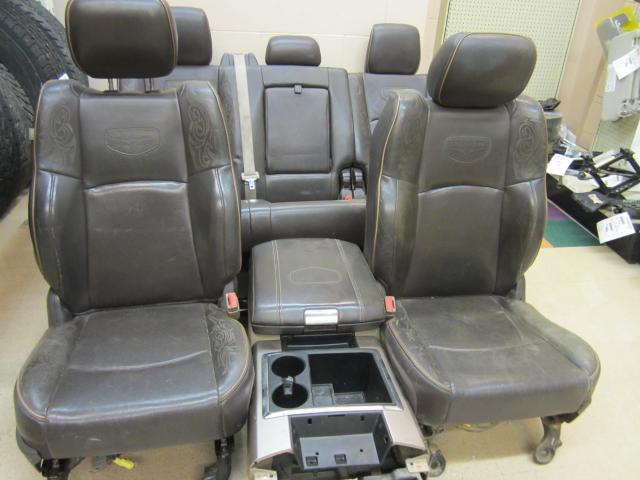

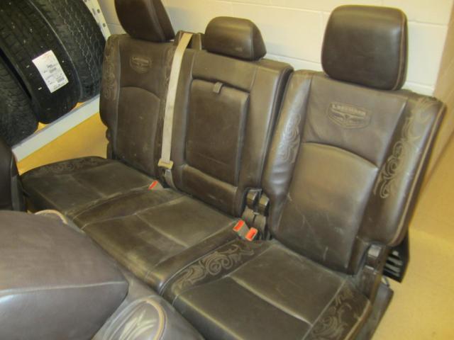

Just won a auction on the remainder of the seats I needed. Now have 4 longhorn buckets and one mega cab bench 👍🏻. The mega cab bench for those unfamiliar reclines and also folds down flat.
