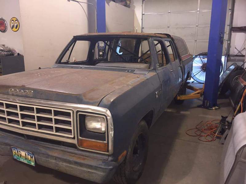

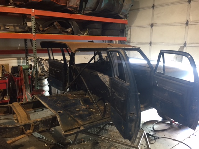

4 door cummins powered Ramcharger build
Old Sep 28, 2016 | 10:16 PM
gyman98's Avatar
Posts: 1,437
Likes: 208
From: Saskatchewan

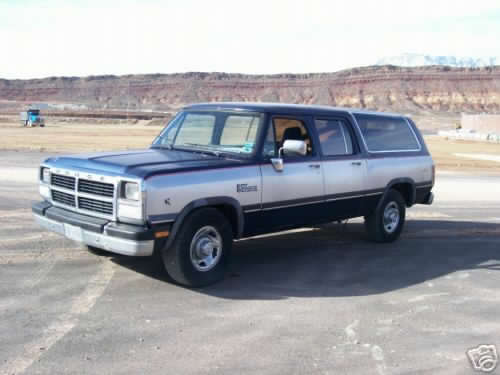

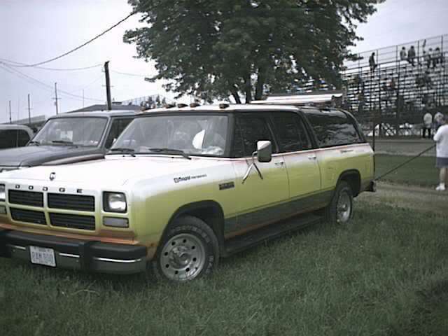

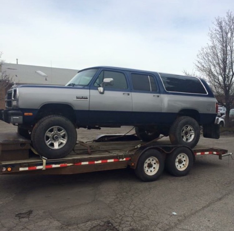

Very cool! I've seen one done yrs ago. Blue/silver up for sale on eBay a few yrs ago. It had some stress cracking where the tub met the CC roof.
Old Sep 29, 2016 | 07:10 AM
gyman98's Avatar
Posts: 1,437
Likes: 208
From: Saskatchewan
That one is still around, seems that it's a 4wd diesel now. I'll find the pics later and post them.

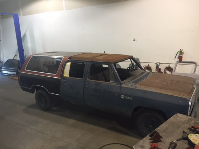

The ramcharger roof top skin is being removed as well and then a ribbed suburban roof is being grafted on

The one I believe to be the eBay truck and a few more pics I have

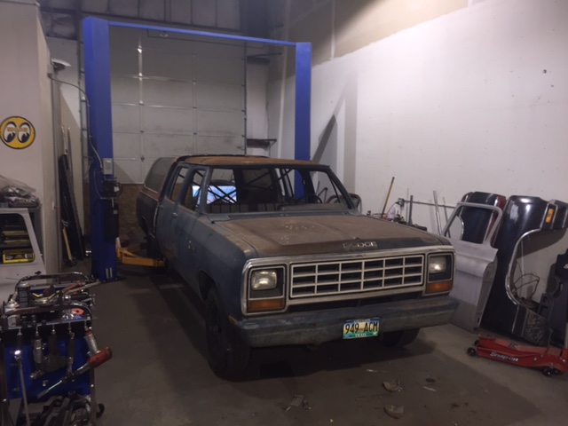

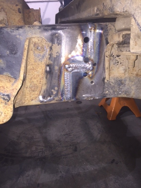

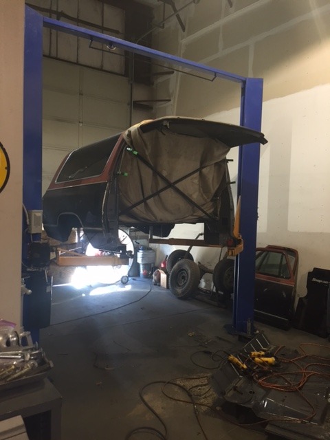

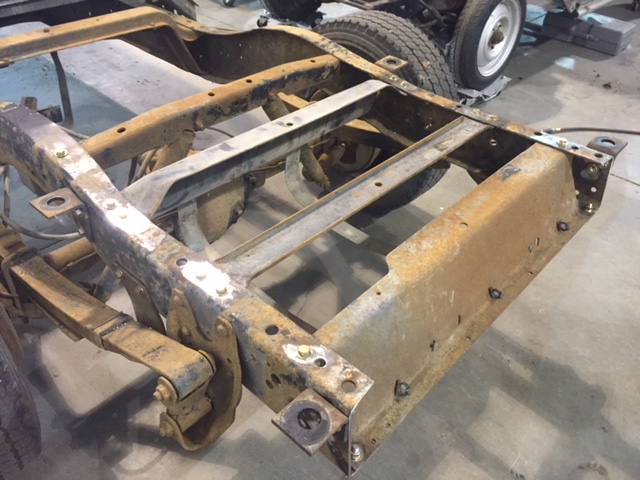

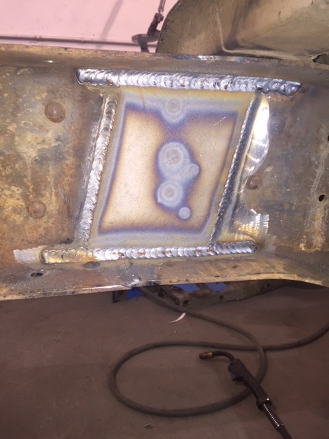

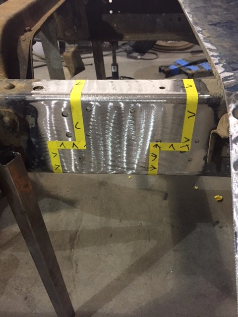

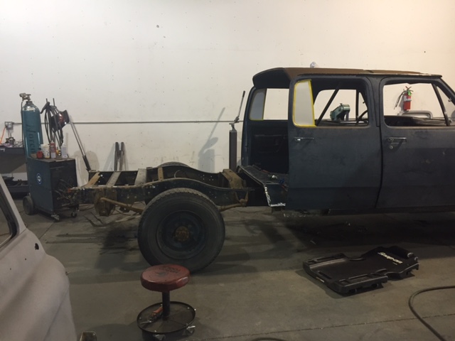

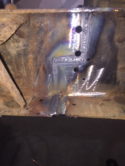

Rear ramcharger gas tank crossmembers and body mounts were installed today as well as final measurements were taken. Frame needs to shorten 8.5" to Center the wheel in the opening and have the proper door gap between the crew cab rear door and ramcharger door jamb

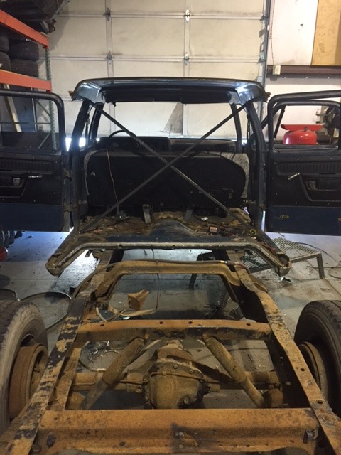

Old Oct 2, 2016 | 06:27 AM
KRB's Avatar
KRB
Posts: 3,241
Likes: 576
From: Central KY
This is way cool.

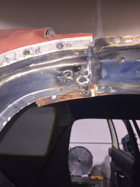

What are you planning on useing on the inner roof panel rust?
Old Oct 2, 2016 | 07:55 AM
gyman98's Avatar
Posts: 1,437
Likes: 208
From: Saskatchewan
Originally Posted by KRB
This is way cool.
The front drip rail area will need to be replaced the rest will be acid treated then couple coats of zinc paint
