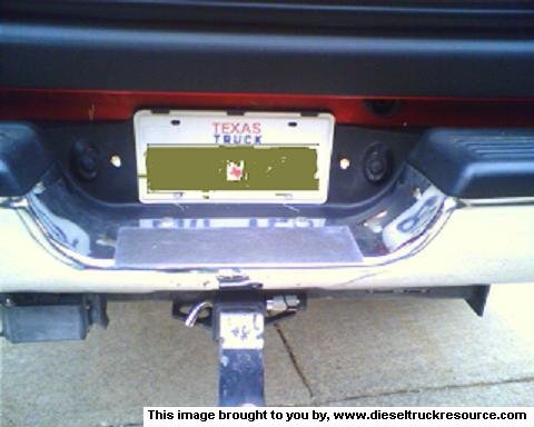

Well, I got the Firestone air bags on yesterday. The installation was pretty straight foreward, but it did take a few hours. As the saying goes "The next time, it will be easier." They do go on without taking the overload springs off, but the bags are at the 5 inch minimum highth. I went ahead and ran the air lines to the rear plate, but may move them to the fuel filler later if I can convienc myself they'll be easy to get to.
I have them set on 18# with no load. You could see the truck raise when I aired them up. I've only driven about 60 miles on the highway, and really couldn't tell much difference in the ride. I guess the real test will be when I load up the cabover camper.
Pardon the cell phone pictures quality.

[COLOR=DarkSlateBlue][U][B]The bottom mount plate for the airbag should be bolted to the two "overload" springs only and should not have those LONG bolts going to the bottom. The way you have it you are trying to compress the overloads with those long bolts. Go the Firestone's website for installation and they will show you this.

Thanks for the heads up. That'll be easy to fix and is probably the reason my ride is not much better. Guess I wasn't paying close enough attention to the directions.
