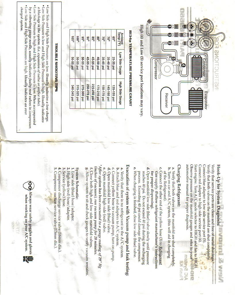

Just happened to be glancing over this thread again. Here's the basic way to test your a/c system with the gauge set. Your low side pressure is set by volume of refrigerant and ambient temperature (nothing with compressor). If I can remember to bring my gauge set in tomorrow I'll throw the chart up here. First thing is to fill low side to the corrected pressure. Then check the corresponding high-side gauge and see where your at. The chart has the approx. high side pressures as well.

I guess my memory works as well as I remember. Went home for lunch. Here's the chart that came with my gauge set, along with the troubleshooting/diagnosing tips, some that I kind of went over before.
