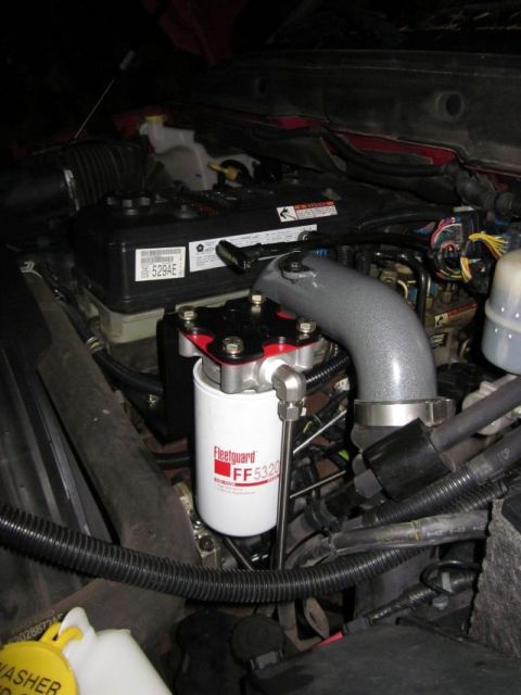

Here's my install with 3/8" 316 stainless lines bent to follow the stock lines and keep them out of the way, along with swagelock fittings. The horn is a nice fit and Richard at Glacier was great to deal with!
Cheers!

These under the hood 2 Mic set-ups look good but i have no room with my Amsoil by-pass as i made a bracket and mounted it on the cylinder head.I don't want to move it either so i was contemplating when time come to mount my Airdog in the tool box in the bed behind the cab(truck has tonnue cover so its protected/plus the tool box.).I saw a guy a while back with a flat deck body job and you could clearly see the Fass mounted behind the cab up high on the flat deck,seat level.I thought this may not work (Joe i picked your brain about this in Red Deer)because the pump may have to work a lot harder due to being higher above the fuel tank.The plan is to mount in the tool box with a 2 mic setup---easy to change filter/protected from the elements ect---may even throw a Transfer Flow 56 gallon larger tank i while i"m at it.My Airdog filters on the 01 sure do take a beating even tucked up under the fender/running board from the gravel roads---the pump itself is Ok but the filter are another story.
