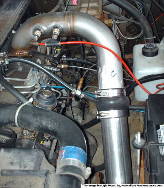

From: New Holland, PA
Originally Posted by Machinos
Do any of those prefab tube/boot kits work directly with a '90 and a PS intercooler?
Mine is an off-the shelf setup.
