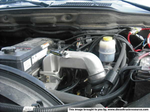

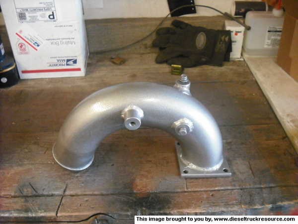

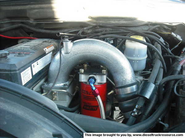

Here is my new setup that I just got on the truck. I couldn't see paying some of the prices that are out there for these setups so I fabbed up my own. I am particularly happy with the 2 Micron filter. Not sure if its just wishful thinking because I made them, but the truck seems to be running better and smoother than ever. Didn't notice a ton of power difference, but there was some. However the truck just seems to run smoother.
Let me know what you think.
Before
After

I see your at it again!! Looks awsome and exactly how I would do one, any chance of making some up for the rest of us? Also where did you get the filter head?
Keep up the great work!
Old Jan 20, 2009 | 10:20 AM
ratsun's Avatar
Posts: 2,342
From: Wet Coast, Canada
That right there is some real pretty work!
If you ever want to make up another intake horn for a DTR brotha LMK

Thanks for the compliments.
I got the filter head online here http://www.adiesel.com/baldwinfilters/FB1311.html
Then I just bought all the AN fittings and hose online from Street Side Auto. Cheaper than Jegs and Summit. I even got my quadzilla fp sender to work with the setup and since it isn't mounted to the engine anymore I think it should last a good long while.
Plus this setup eliminates all of the banjo fittings, not sure how much of a difference it makes, but I know it looks better and I have 2 micron filtration now.
I might consider building some, I guess it would just depend on price and when I have time available.

Looks great.. But ditch that Baldwin filter.. its not a 2 micron. Its a 7 micron filter, using the same standards that Cat/Donaldson/Fleetguard use... Baldwin calls it a 2 micron filter based on multi-pass ratings, single pass is what you want to know for fuel.
The best filter for the 1-14" thread is the Cat 1R-0750 or the Donaldson P551313, both are 2 microns absolute.

Yeah there is a lot of info out there about filters and I'm not really sure who to believe etc. I'm fine with it on there for now, but I may end up changing it in the future.
Here's some interesting reading for you about filters, I know you have done your research I have seen your post on CF. Just a lot of contradictory info out there.
http://www.baldwinfilter.com/literat...tins/95-11.pdf
http://baldwinfilters.com/literature...etins/98-7.pdf
http://www.baldwinfilter.com/literat...etins/98-2.pdf

Yeah I went rounds with Baldwin and they finally admitted that the ratings they use are multi-pass, and then I got the single pass numbers, which is what the other use...
Any extra filter is better than nothing, that's for sure.

I'm running this additional filter in connection with the stock fuel filter/water separator.
