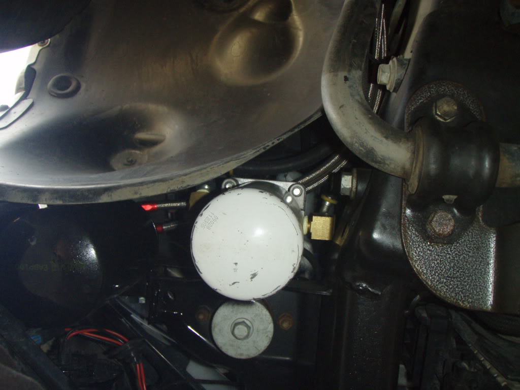

I've had this kit for over a year and I think its a very worthwhile investment. No apparent restriction, I have about 17 psi pressure at the CP3 at idle. You dont need the GDP horn necessarily, mine attached very readily to the BD intake horn, just had to drill and tap one or two holes, cant remember anymore, lol. It may not be perfectly vertical but that doesnt matter too much.
Stephen at KhaosKustoms made a bracket and relocated the 2 um fuel filter and the amsoil auxiliary oil filter to a spot between the bumper and front wheelweel on the driver side. Easy access to both filters and tucked out of the way. Love it!
