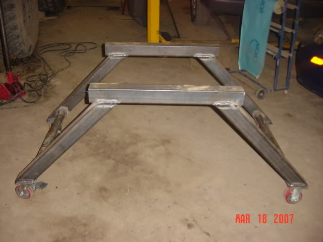

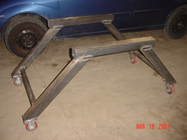

Old Aug 31, 2009 | 08:12 PM
  #100
1-5-3-6-2-4's Avatar
Posts: 3,142
From: Okotoks AB
you can use my rotator stand no problem if you want............
these bolt to the engine mount pads and "in theory" should hold the engine mostly neutral. I have saddles that need to be welded to the frame there 1 on each side. but I didn't want to do that until I had an engine rigged to center it.

From: Fort McMurray, Alberta
That looks cool Luke, will it hold the engine firm enough to be able to torque things down?
no doubt about it. its heavy. I put double locking castors on one side and non steers on the other. it might not look heavy but the frame just as is, is a heavy sob.
