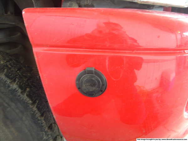

RocketJohn's Avatar
Posts: 217
From: Denver, CO
I just installed this, this week... pics below...

Old Dec 18, 2007 | 11:47 AM
RocketJohn's Avatar
Posts: 217
From: Denver, CO
yeah but mine is mounted with a metal plate and it doesn't look tacked on the side of my bumper... :P
