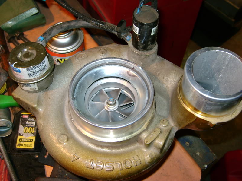

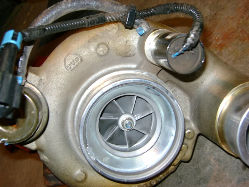

I was looking at an HE351 today....I see that it has a hose running from the wastegate into the area by the electronic solenoid.
After the electronic solenoid is plugged or disabled, what are you guys doing with the fitting for the hose (by the solenoid)??
Are you guys just running the hose in the adjustable boost elbow and plugging the stock hose fitting?
Old Apr 24, 2009 | 11:11 AM
  #221
AH64ID's Avatar
Posts: 4,737
From: Kuna, Idaho
I think thats the most common. It looks too tight to get a boost elbow in the stock hole, but you could probably put a 45* fitting in there and get the eblow i the 45* fitting, if you didn't want to drill any more holes.
