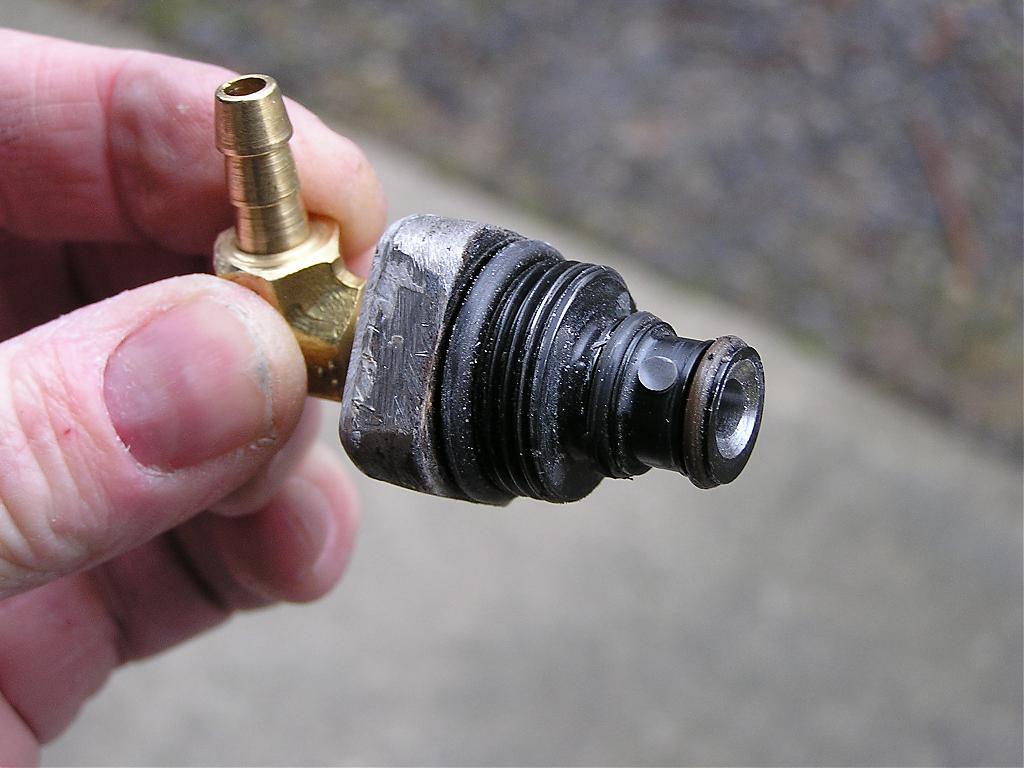

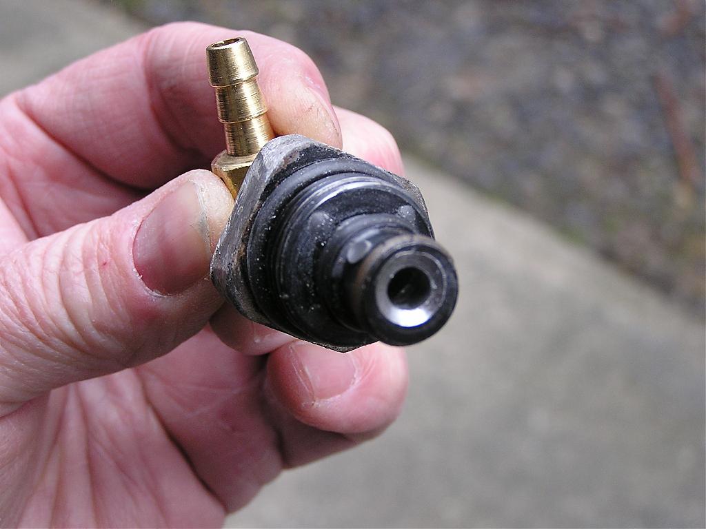

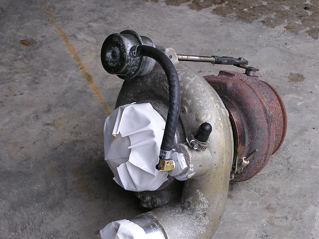

if i did this correctly here are some pics of home made ats plug and elbow installed.

Huntinut,
Let us know if your trick worked for the wastegate, if it does that is how I will be doing mine!

I run the smarty JR and it likes the 351. Magilla get one you will like it. The wastegate on the 351 I have starts to open at 15 psi and is fully open at 22. I shortened the rod and got 26. I bottomed out my boost elbow and got 35. I would try an actuator off of a 341 on a 305hp engine. Shorten the rod a 1/4" and it should be better. You can adjust the wastegate on the truck but you have to remove it once to drill out the set lock in the rod will a 7/64ths bit. You also have to apply regulated air to the actuator to get it back on the wastegate. Apply air and see when it opens. You probably don't need a boost elbow it you just adjust the wastgate rod or just clamp it off. Having a functional wastegate should free up power at max boost.
