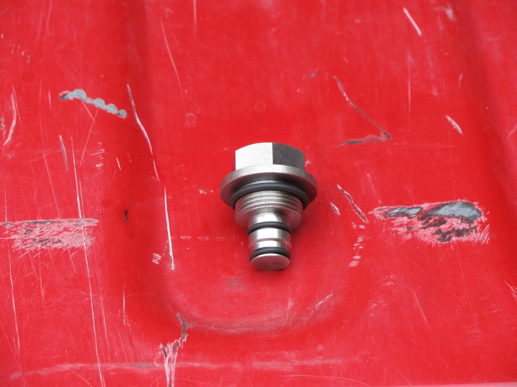

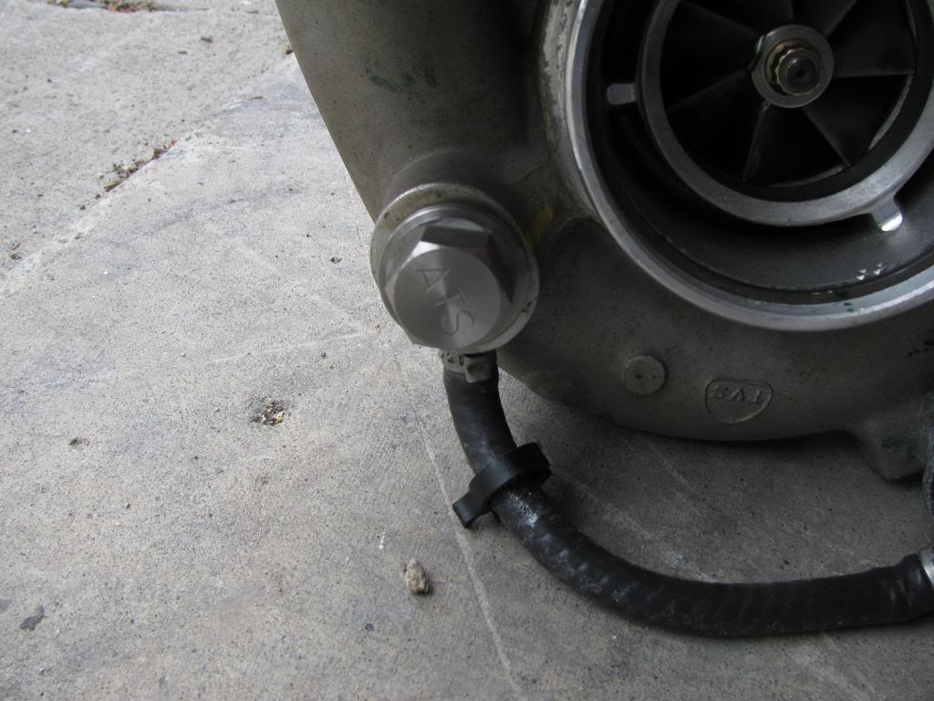

I just wanted to pass along a little info for those interested in this popular turbo swap. ATS Diesel has a Wastegate solenoid plug cap that really cleans up the install of these turbo's & eliminates the worry of boost getting by the solenoid & having to plug the bypass holes. Install this plug, drill & tap the compressor housing for an adjustable boost elbow (available on e-bay) & the turbo is ready for upgrading 2003 - 2004 trucks. It's a direct swap & really wakes up these early common rail Dodge's.
Part #'s for the ATS plug:
2272-202-003 Wastegate solenoid cap
9263K143 O-ring (1)
9263K305 O-ring (2)

When I ordered mine(about 2 weeks ago), they only had two o-rings on the invoice but sent me three(all on the plug).

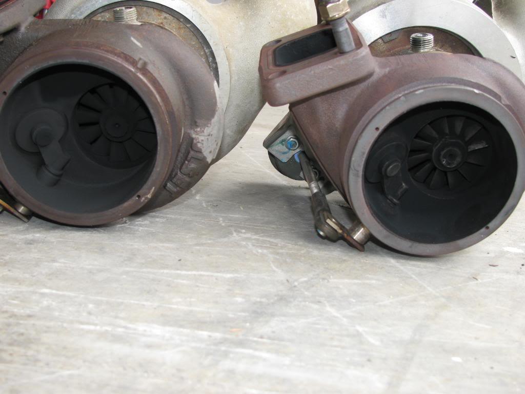

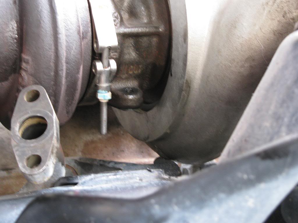

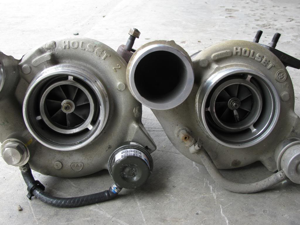

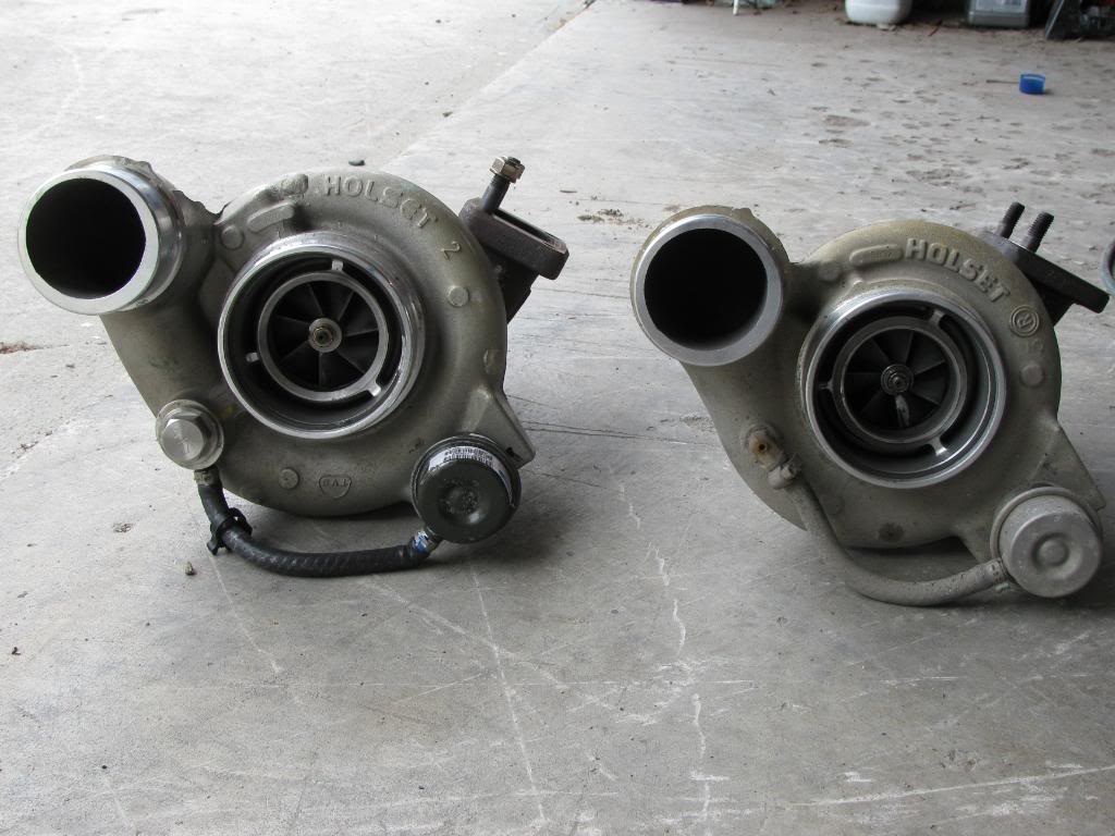

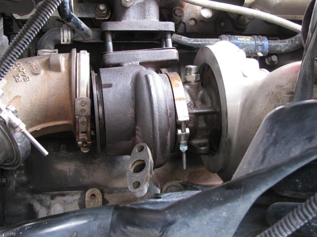

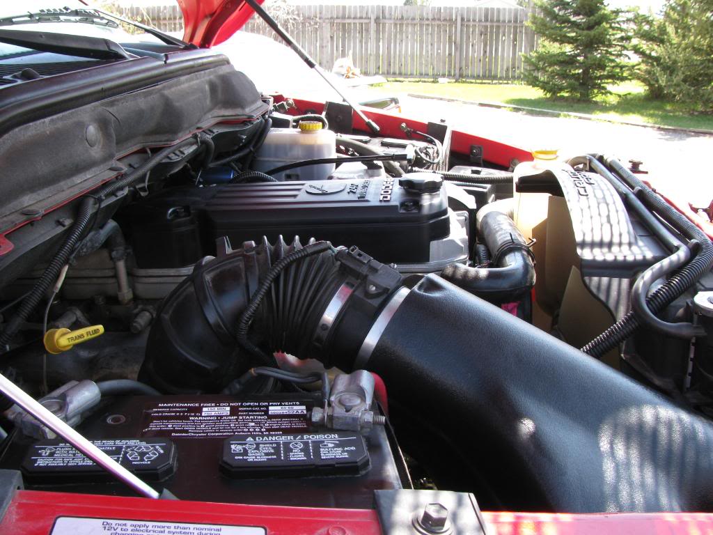

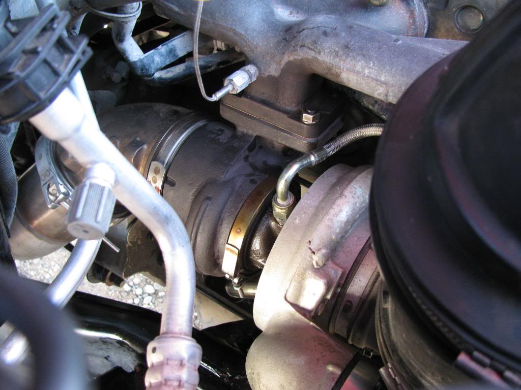

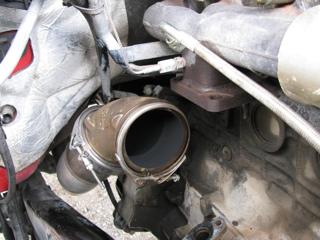

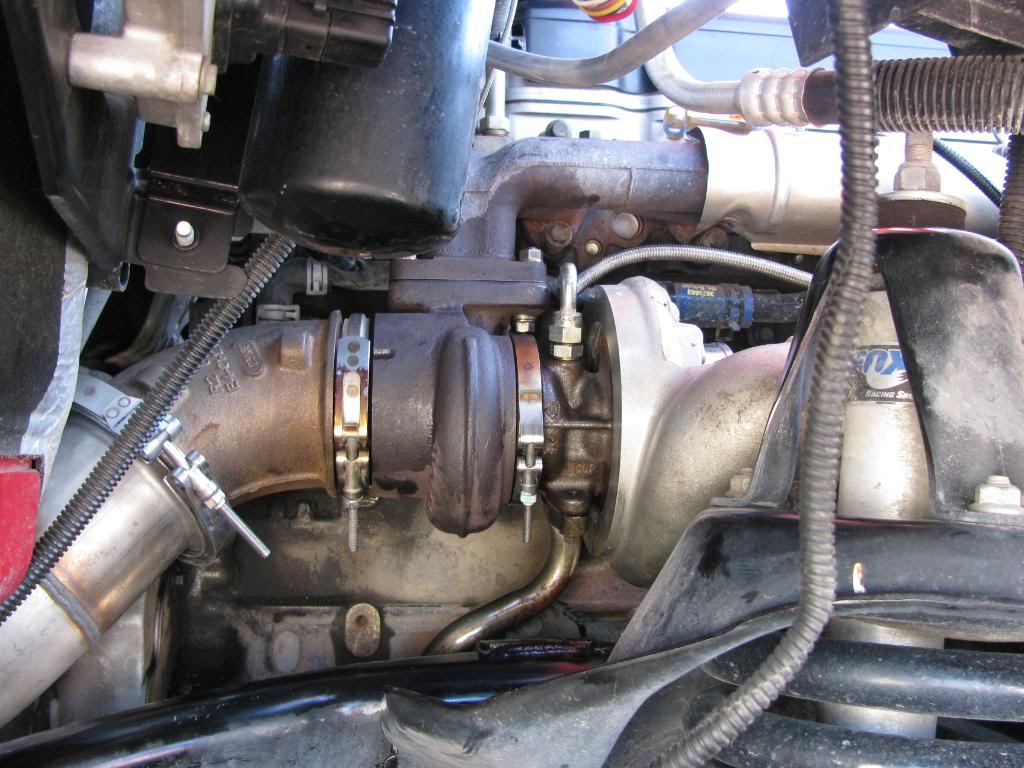

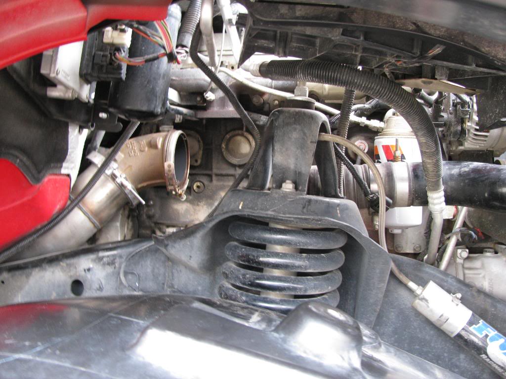

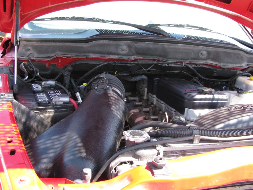

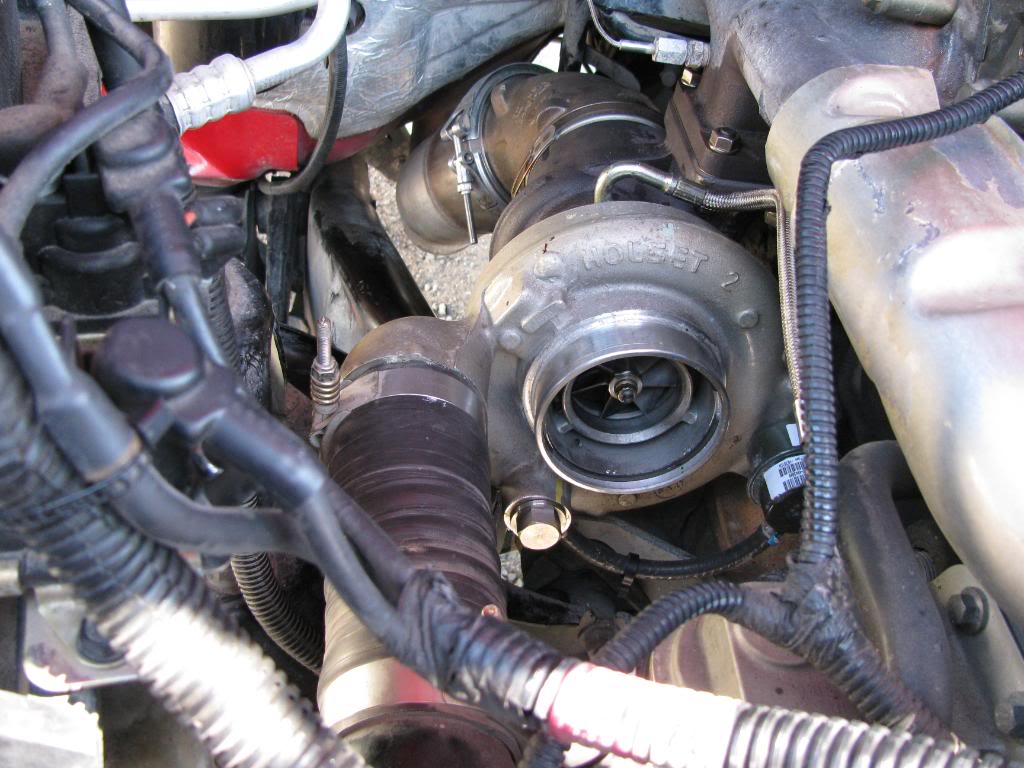

Finally got her on!
Went on easy. 15mm box end wrench pulled the four nuts off the manifold no problem. Didn't even need a breaker bar.
PB blaster might of done the job though. Soaked it last night and had been spraying it off and on for the last few weeks.
This was pretty easy. Took me about 3-3.5 hours. Would rather swap turbos then do an exhaust honestly. Definitely would rather swap turbos then install another Airdog.
I included pictures. The only thing that is tight is the compressor housing near the motor mount. This is close, especially with the 2 longer studs. I used a prybar and she popped right into place though.
The only thing I would do differently if I did this again would be pull off the tire for even more room in the wheel well. I can't see pulling the manifold being easier at all. Maybe if your putting Silver Bullet 66 on there and need that room.
As for the results I am very happy with it. Truck definitely feels more responsive for sure.
EGTs are pretty similar to before, maybe a tad lower (50-100 deg). SW5 on the Smarty Wide open pull from 15 MPH roll resulted in egts of about 1100 ish deg and that was up to about 90 MPH. Ater my exhuast but with the 341 I was running about 1150-1200 to 80 MPH.
Boost was right around 32-33 psi. I did not hook up the wastegate or boost elbow at all.
Now I tried SW 7 briefly for the 1st time. WOW, SW7 runs a lot harder then SW5. Now boost was running about 36-38 psi and egts to about 70 MPH were around 1200-1250.
These #s are about perfect for me.
Now I just need to order my converter so I can SW7 all the time
