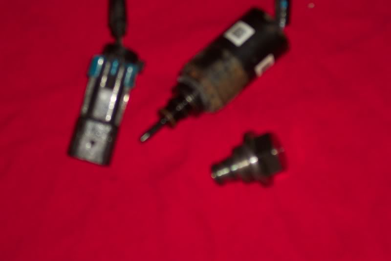

I just wanted to pass along a little info for those interested in this popular turbo swap. ATS Diesel has a Wastegate solenoid plug cap that really cleans up the install of these turbo's & eliminates the worry of boost getting by the solenoid & having to plug the bypass holes. Install this plug, drill & tap the compressor housing for an adjustable boost elbow (available on e-bay) & the turbo is ready for upgrading 2003 - 2004 trucks. It's a direct swap & really wakes up these early common rail Dodge's.
Part #'s for the ATS plug:
2272-202-003 Wastegate solenoid cap
9263K143 O-ring (1)
9263K305 O-ring (2)
I'm sorry about the quality of the pic's & i hope this helps.

The plug & o-rings were around $40.00. It's a very nicely machined, well thought product & well worth the money in my mind. Again this is not needed to use the turbo in a swap but does clean up the install. I've removed the solenoid, plugged the bypass holes, reinstalled the solenoid & that works also.

Excuse my ignorance here. Is that plug only being used to eliminate the electronic wastegate?
So this turbo bolts directly up to a 03, you won't need a different down pipe or anything else would you?
Old Jan 29, 2009 | 07:34 PM
UNDER-PRESSURE's Avatar
Posts: 337
From: CENTRAL FLORIDA
The plug is only used to eliminate the unused solenoid.
You can retain your stock downpipe but you will get lower EGT's using the 04.5 up 4" exhaust elbow & downpipe.
