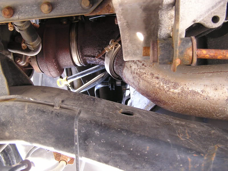

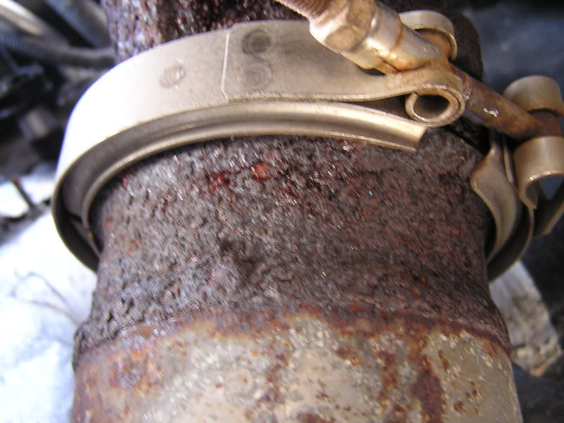

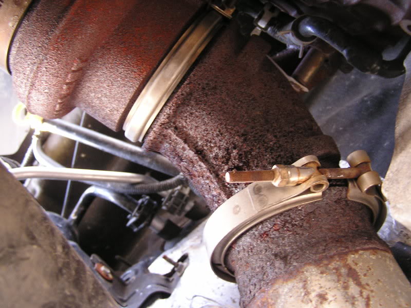

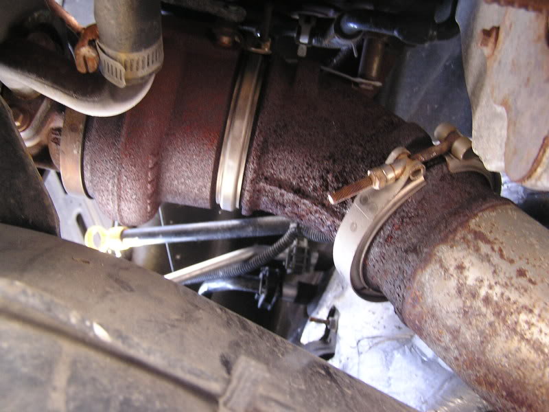

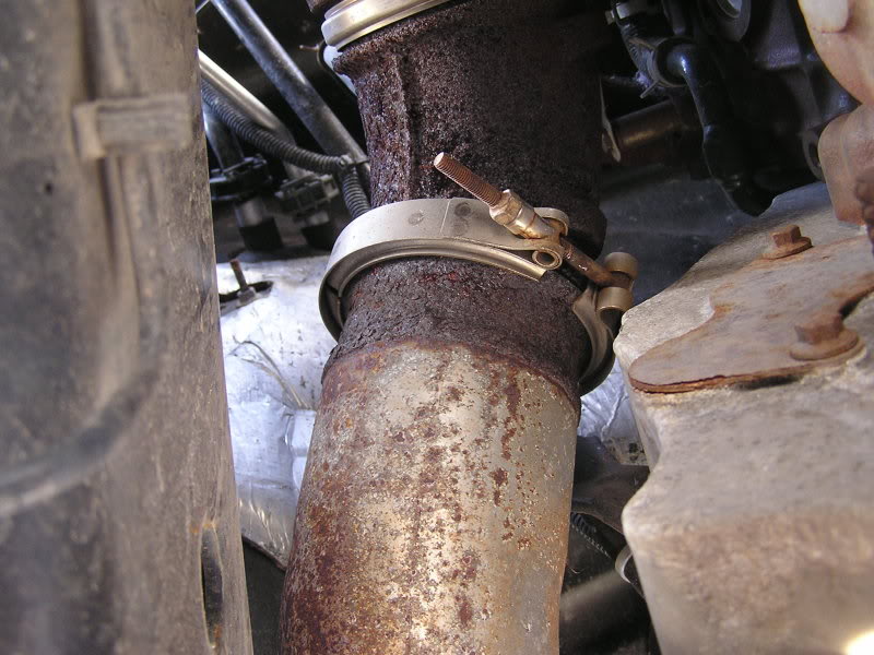

Ok.........well I took some pics of the stock turbo and what appears to be a stock elbow.
The 5" MBRP exhaust seems to be welded to a small, in length, exhaust 'downpipe', which is clamped to the elbow.
The small piece might be what MBRP called a 'downpipe', which is maybe 2" long and appears to just be clamped to the stock elbow.
What do you guys think:

That is the downpipe that bolts to the elbow but the whole thing is the downpipe, not just the 2-3" piece at the top. That piece at the top is just the flange that they put on a generic DP so that it fits an 03-04 truck. If you bought a system for a later truck then the DP would be exactly the same but the flange would be larger.
IMO, that is a lot of money for that manifold, which is gonna give you minimal gains, unless you plan on making big power down the road....
