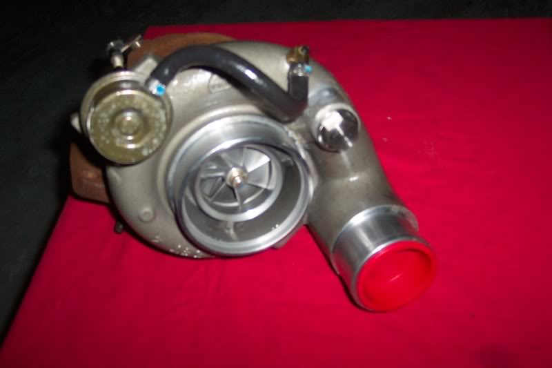

the solenoid cap is the shinny hex head below the boost elbow?

Originally Posted by mostly stock
under pressure
Yes that's it. It's a well made piece that plugs several unused passages in the compressor housing.
