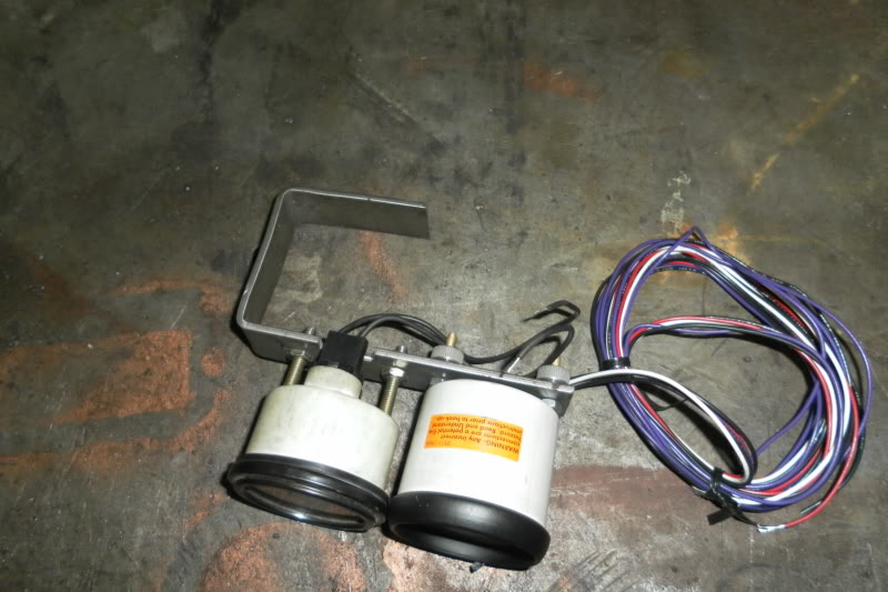

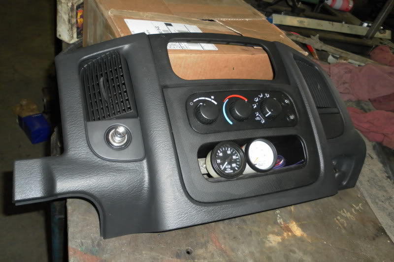

i put in 2 fuel pressure gauges yesterday, lift pump and rail pressure, so if it dont start again i will have a clue on what's going on.

there was no place to put them, my pillar post has a handle, didn't like any other option i found, so i put them in the little pocket it didn't use. if i want to put it back to the way it was the pocket is held in with 4 screws and i can replace it cheap. i had to drill some holes in it for the wires and to secure the mount plate i made.
Autometer rail pressure that matches the Dodge instruments, it hooks up to the engines sensor for its signal, i had a Ispro fuel pressure gauge.
