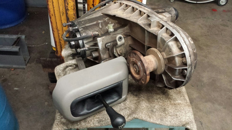

I did complete the manual shift T-case swap. It has not shifted itself since either!!!
Rebuilt the case. Found a crack in the front half while it was apart. Welded it up, and it hasn't leaked yet. Other than the "SERV 4WD" idiot light staring at me, it has performed flawlessly.
Installed a double deep Mag Hytech tranny pan, and rear diff cover. Diff cover was a splurge. But, the tranny pan was a must. I am a firm believer in deep cast tranny pans. Soo many benefits. But since then, the front pump seal has started puking. I need to pull the tranny to change it. This tranny acts/shifts soo good, I am afraid to mess with it, LOL.
