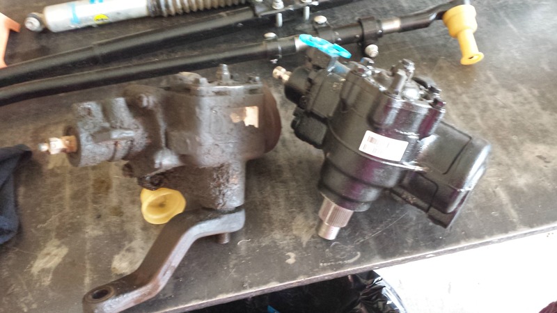

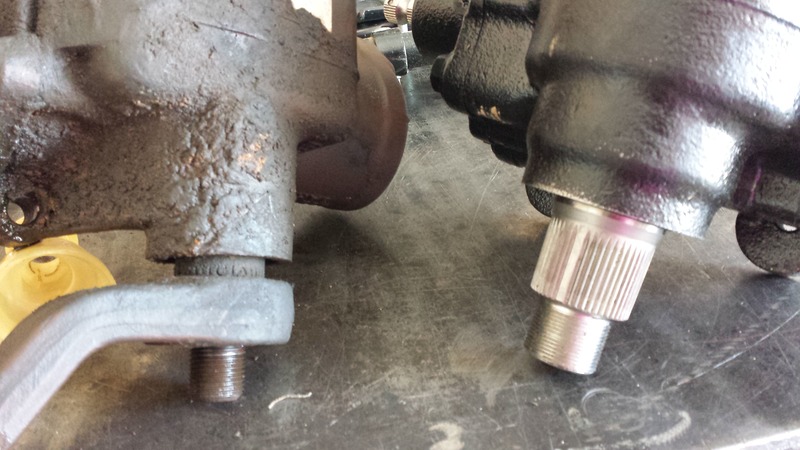

And for anybody wondering what this "upgraded" Mopar steering box is all about, here are a couple pics of the original box next to the big-bertha box:
Pay particular attention to the massive sector shaft in the new box. Good stuff!
