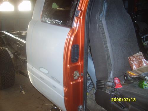

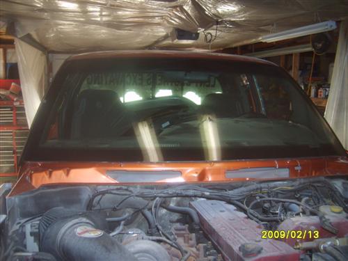

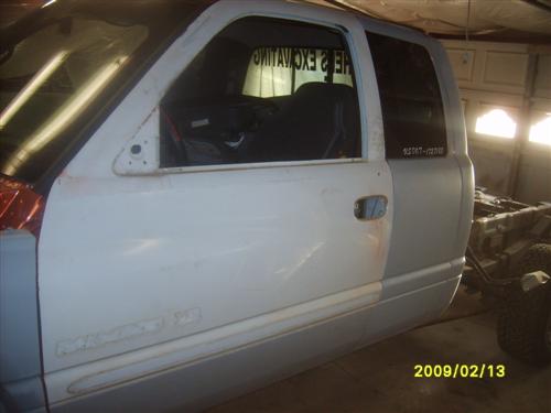

I got some pics today. Don't look like much has been accomplished, but I didn't work on it much lately.
New windshield. The engine bay collected some dust.

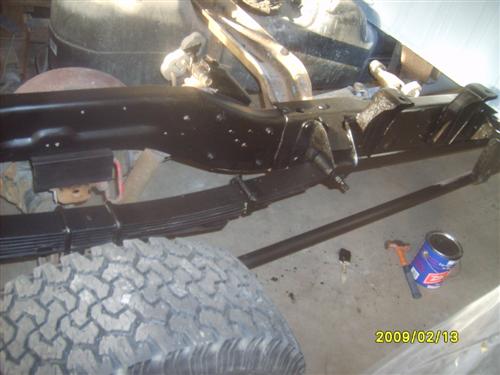

Painted RH frame.

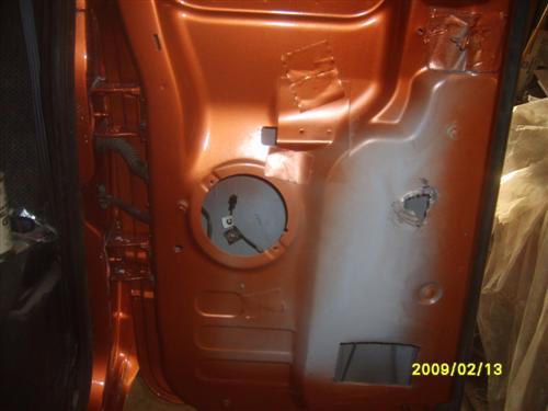

Doors are on.

What did you coat the frame with? Is that POR?
Old Feb 14, 2009 | 04:46 PM
  #128
TIMMY22's Avatar
Posts: 1,971
From: Land of milk and honey.
Chassis Saver,
I recommend dropping the fuel tank and getting in behind it with the wire wheel, wax and grease remover, then POR or Chassis Saver. I've seen trucks actually break in half there!

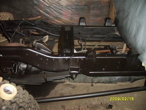

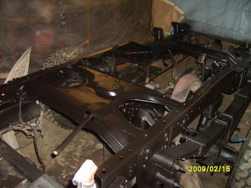

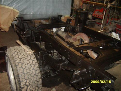

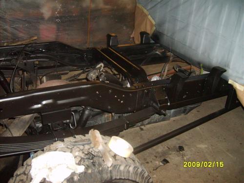

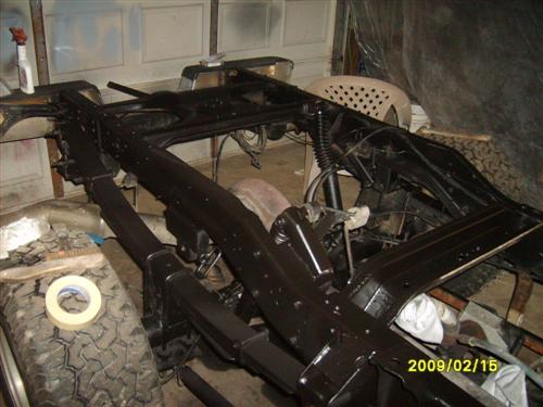

Got the rest of the frame done, up to the cab. I'll be doing the rest from my buddies pit after the truck is done. I applied Picklex to the entire frame, then I sprayed 4 coats of zero rust on. I also removed the fuel tank & got that cleaned up. I am gonna order 2 new shackles for my springs, they are rusted pretty bad.
