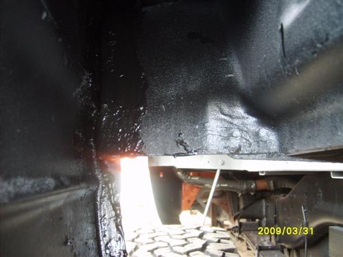

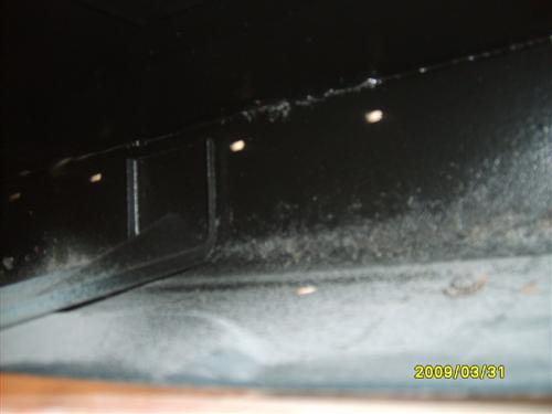

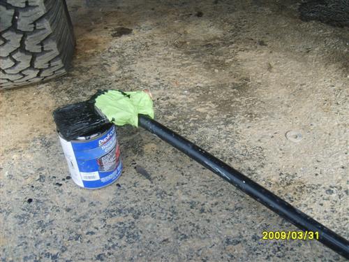

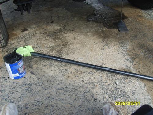

I coated my inner wheel wells with Duplicolor bed liner. I made a brush hooked to a pole & gobbed it on so that it ran down between the wheel tub & bedside. I also did inside of my doors same way. I took a few pics.

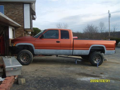

Few more.
