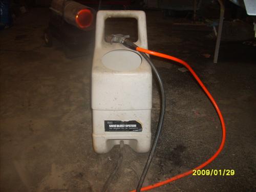

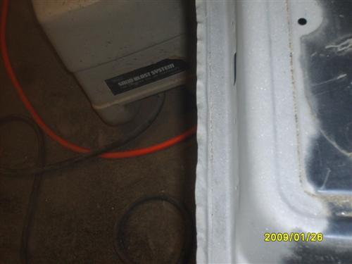

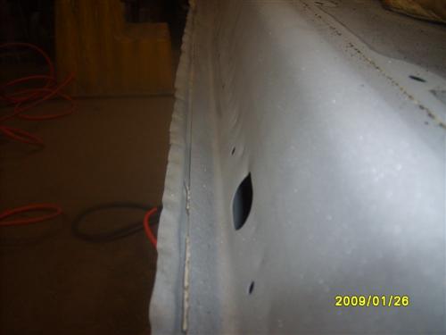

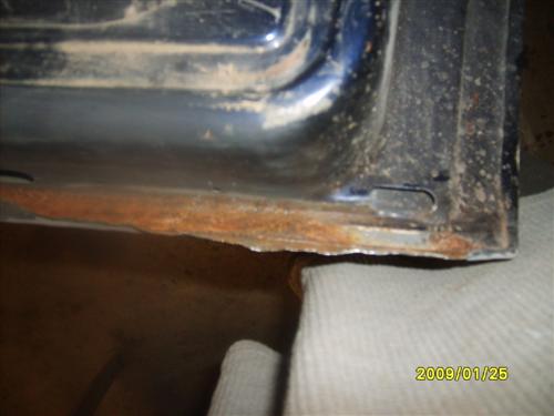

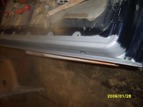

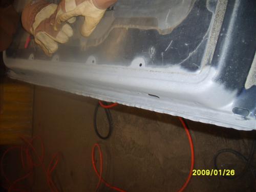

I found some surface rust on my rh front door. It was hiding, but I found it while sanding. I sandblasted the lower door & peeled the door skin back, then sandblasted inside also. Then I reattached the door skin with door skin adhesive & cleaned/coated the metal with Picklex. I'm gonna finish sanding this door tomorrow & hopefully start on sanding the rear door so that the paint can fly.

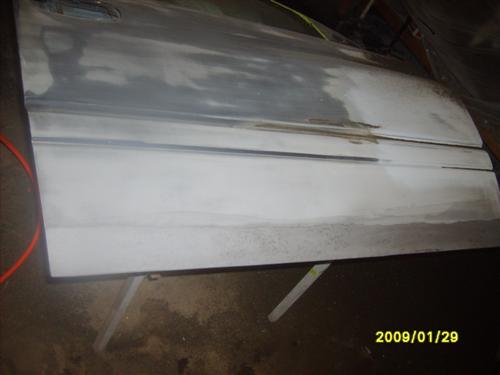

Today I blasted the outside of the lower door & coated with Picklex. This door is about ready for epoxy. I have been working long hours & haven't worked on the truck much this week, but hoping to be spraying the last 2 jambs this weekend.

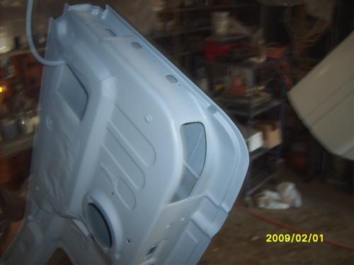

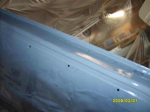

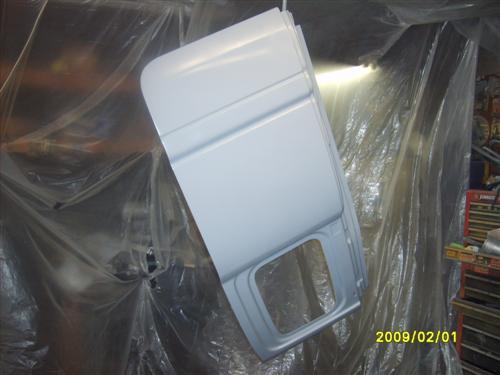

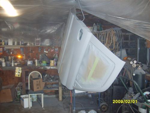

Nice day today. I got the last 2 doors in primer & ready for sanding, then the paint will fly....on the jambs anyway. Then I'll be ready to hang the doors & get them adjusted/working properly. Then the cab, front clip will be ready for the next nice day. I would shoot them today, but MY STEELERS GOT A SUPERBOWL TO WIN!!!

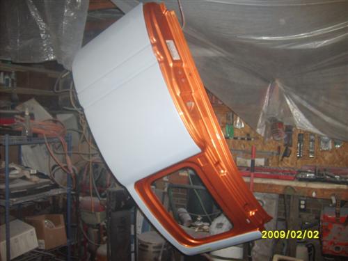

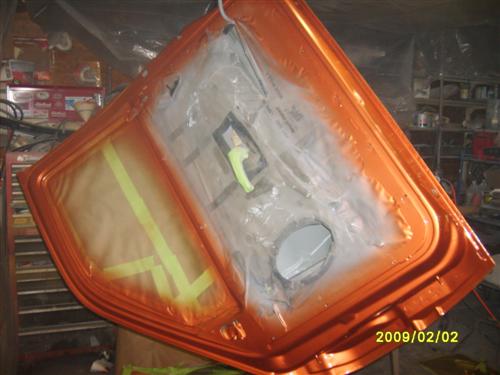

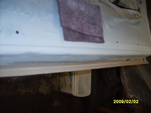

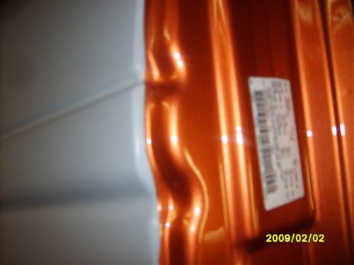

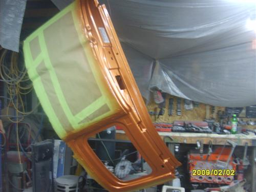

Shot the jambs today, I also forgot to post pics with seam sealer on the bottom of the doors. Here you go, ready to install all 4 doors now!!!
