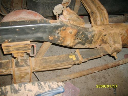

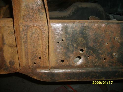

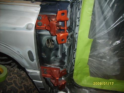

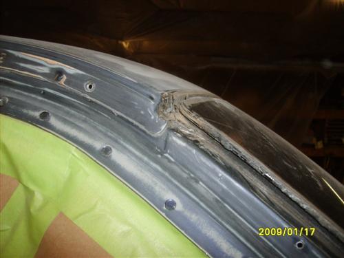

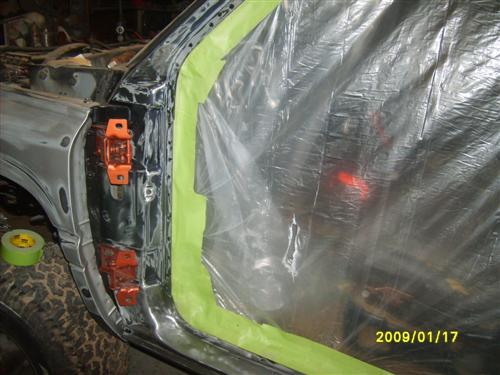

Today I sanded the drivers doorjamb, sanded rocker to bare metal then coated with Picklex, Cut the weatherstripping out of front window, replaced drivers side door hinges [that was fun], then wire wheeled the outside of the passenger frame rail.

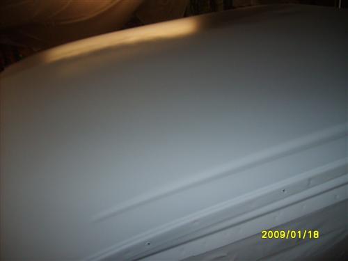

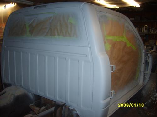

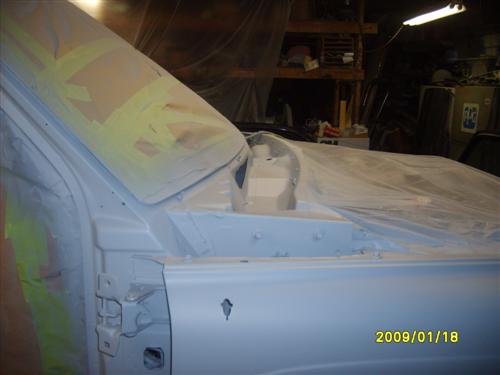

Finally started the fun stuff! Shot the cab/front end in epoxy primer, then high build urethane. The truck is baking right now, but looking good doing it. I'll get pics when the fumes clear out.

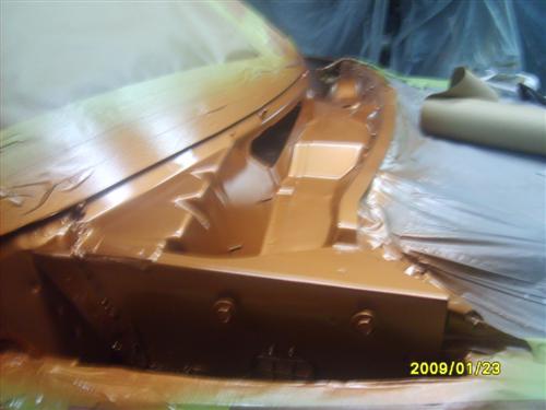

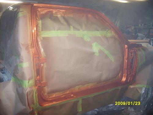

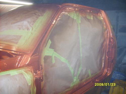

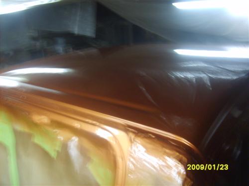

Nice day today:rockwoot: I shot the jambs, roof & cowl.
