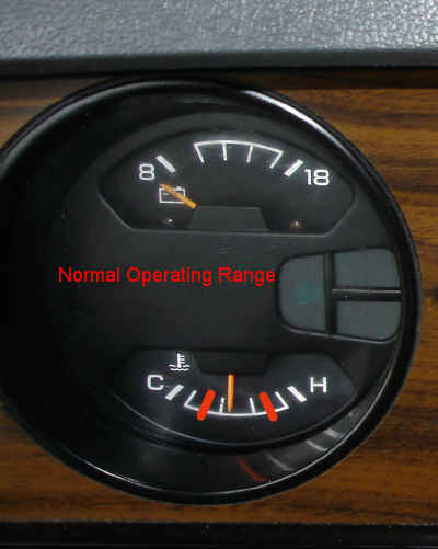

Mine does the same thing, and is gradually getting worst. It started with me noticing when I first cranked I could see the rise and fall of the temp gauge at idle as what I suspect is the thermostat opening and closing. I then changed to the Cummins thermostat thinking that would help and it did not cure that problem. Now even on flat ground its runs right in the middle of the gauge and if I go up a hill or mash it to pass it rises over a little past Wannadiesel's high operating range mark.

When I installed my h2o temp gauge I realized that 'normal operating range' on the stock gauge was over 200deg

I bet the "H" on the gauge means about 240 or so.

Wow but my question is this . I have installed autometer gauges in my truck and when that baby hits 180 my stat opens up then i wait till 190 and i throw my electric fans on. Is this the right thing to do?

Sure, 190 is plenty warm. 220 is as about as hot as I'd want it to ever get, but there's nothing wrong with running around all day at 210.
