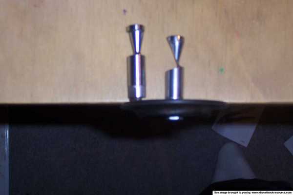

I ground my own but I have read that the Denny T pins and the Old Smokey pins are pretty good. The ones to stay away from as far as scoring in the metal are the Bully Dog pins, I think that the metal they use is softer than the others.

Originally Posted by 77machomopar
Free89: did you grind you own pin? How did it turn out. Thanks
Mine is pretty drastic but I like it. Here is a pic of mine (right) vs. the stock one
