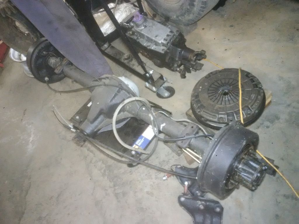

My leaky cooling system has turned into a shot water pump and rad. Was quoted $775 for the only radiator I can get in time.
New plan. Mothball the W250. Mobilize the D250. Will take a little more labour, but no parts to buy.
Spent yesterday hauling out those parts. (Murphy waited till I had them installed in other projects )
Should know pretty soon if swapping in a D60FF is plug & play. I hope it is. It has a lockright

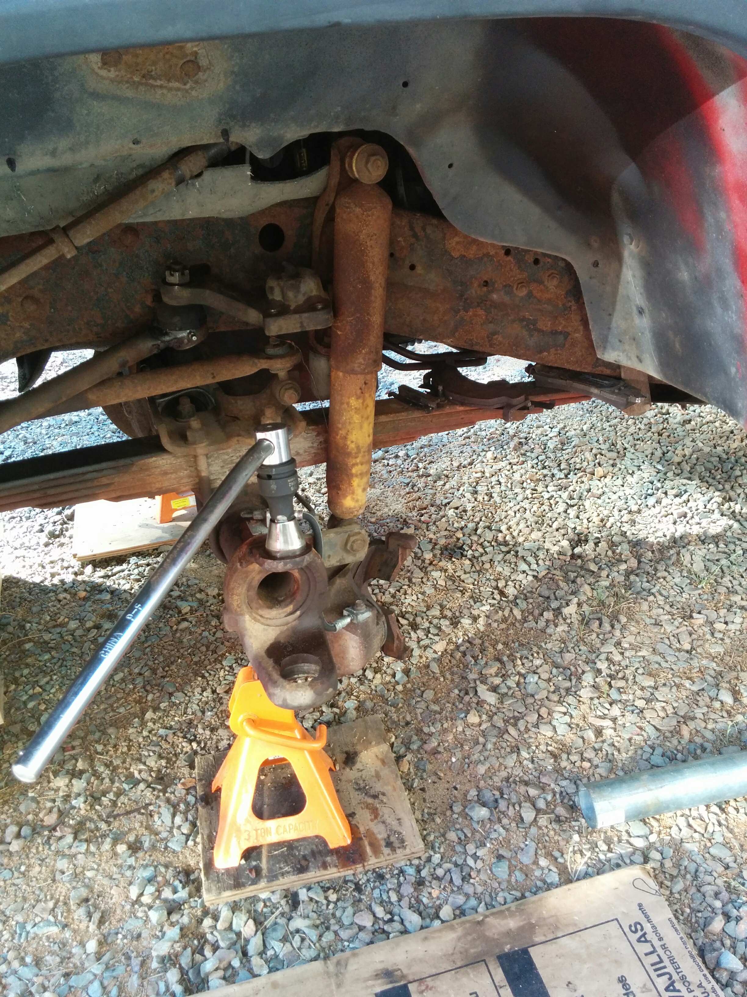

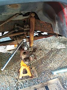

So, how do you break those little buggers loose? I have to get a real breaker bar since that HF piece of something just bends. I have a real long piece of pipe but it's hard to get traction on the gravel. How much can you safely heat the cast "C"?

3/4" breaker bar and a pipe to extend it. Once it breaks loose, prepare yourself to release pressure, otherwise you'll go flying..
I didn't need heat. Threads were sparkling clean when I pulled the cone out.

What kind of grease do you pack the bearing and bushing with? I tend to use StaLube Hi-Temp wheel bearing grease on everything! Then some sort of red chassis grease for everything with a zerk.

Yup, I used a long 3/4" breaker bar with about 8 feet of leverage from 1 1/2" 1/4" thick square tubing, for around 10' of leverage. Tman is right, watch your knuckles, when mine broke loose, they then threaded out by hand. IIRC, the king pins are factory torqued to around 900 foot pounds...Msrk

I cut a hole in a flat 3X6" 1/4"thick piece of iron with a hole saw and welded it to the cone. after it cooled down it only took a light tap with a 5# hammed to break it loose.
