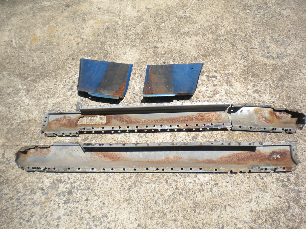

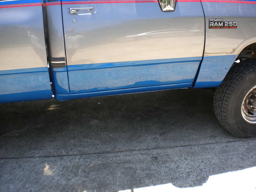

Well I finally go to changing out my rusted rockers and lower fenders, just shot the color this morning. She's also getting a new carpet and stainless sill plates. Also I did the door stiffener mod and I'm really impressed with the result.
The fender isn't bolted in at the bottom yet that's why the gap looks so horrible.
Looks great...

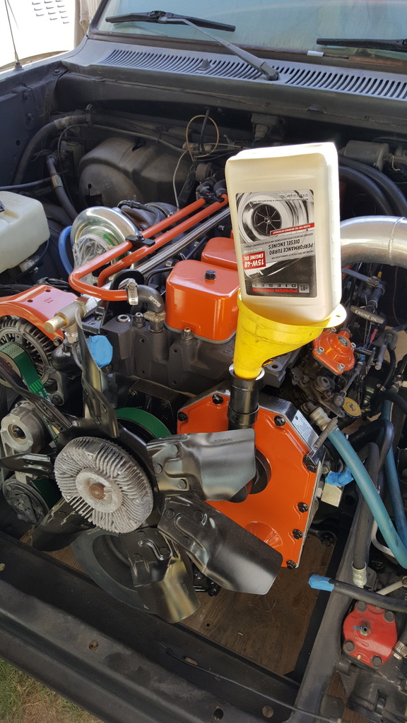

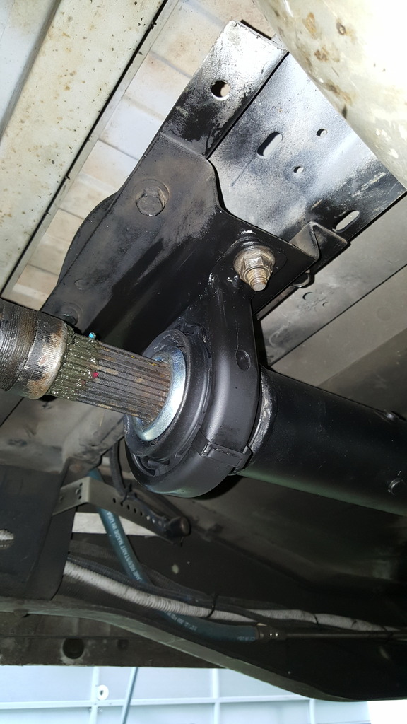

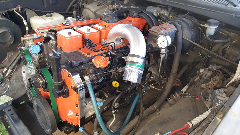

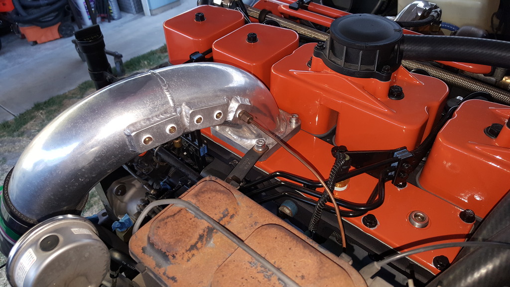

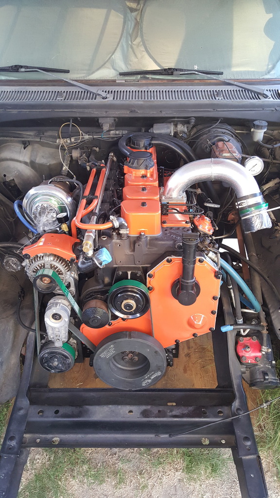

Finally had a couple of days of freedom to get more done to my project.
All electrical connections to the engine made. Vibration damper, fan pulley, belt and belt tensioner installed. Fuel return lines connected to the steel lines at the frame. Fuel supply connected to the VE inlet.
Dipstick and tube installed. Throttle linkage and brackets mounted and connected. I plumbed the tubing for the boost gauge in the air horn rather than in the head as it was before. Looks a bit cleaner since you can't see it from the front.

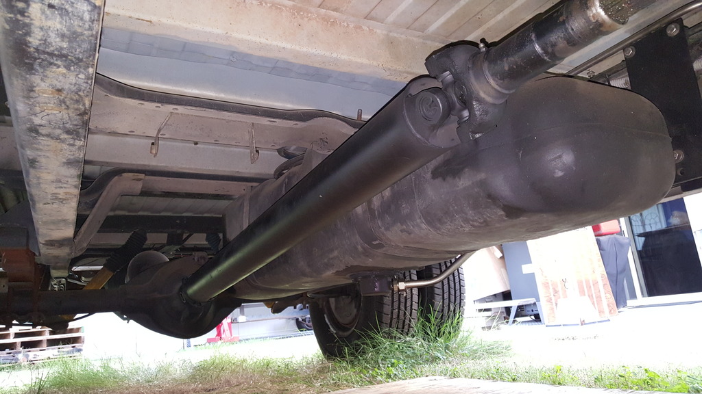

I took the driveshafts to a driveline shop for balancing and to have new non-greasable Spicer u-joints and a center (carrier) bearing installed. The shop found that the long tube was tweaked lightly and needed straightening.
Once the intermediate shaft was in, I filled the transmission with 6qts. of Amsoil Synchromesh 5W-30 MTF.
The engine was filled with 1.5gals of PDD's oil. The remaining 1.5gals with go into the pre-oiler and the majority of it will fill the oil rifle and passages prior to the first start-up.
Lookin good

SOAB!!!!! That is freaking awesome! Man, you have done some really sweet work in there! Can't wait to read (maybe even hear?) your "Lit it up" report!
Cheers!
Mike

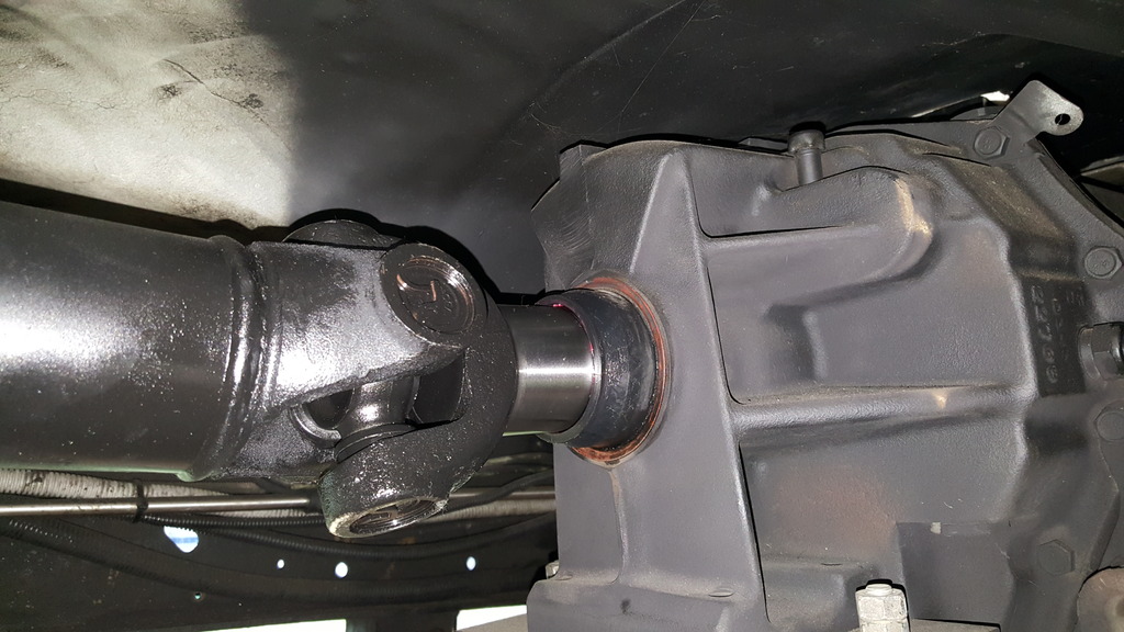

Took the drive shaft out of the truck after replacing the rear u joint and still having a grinding click. Pretty **** sure this ones the problem!
I'm 6'5", 240, equipment opperator and I could barely get the joint to rotate!
One cap had broken needle bearings and the other no joke had the dust needle bearing make when they are ground into a fine powder!
