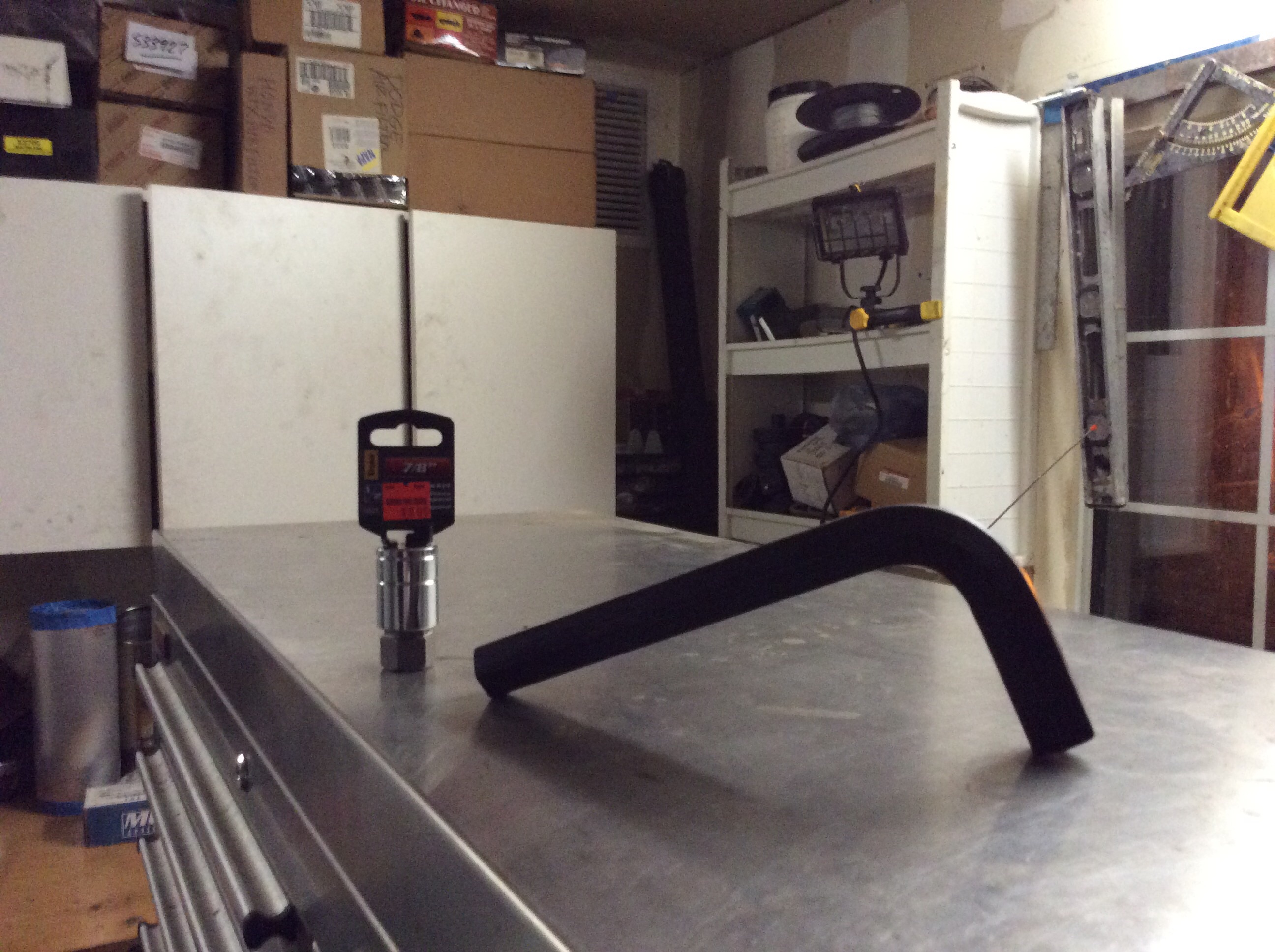

Here they are, Mark. 22mm for the L shaped Allen wrench.

I have a piece of 7/8 hex stock. It was a bar end from some special bolts we were making in my machinist days. I was also looking at a 3/4 drive 7/8 Hex impact socket.

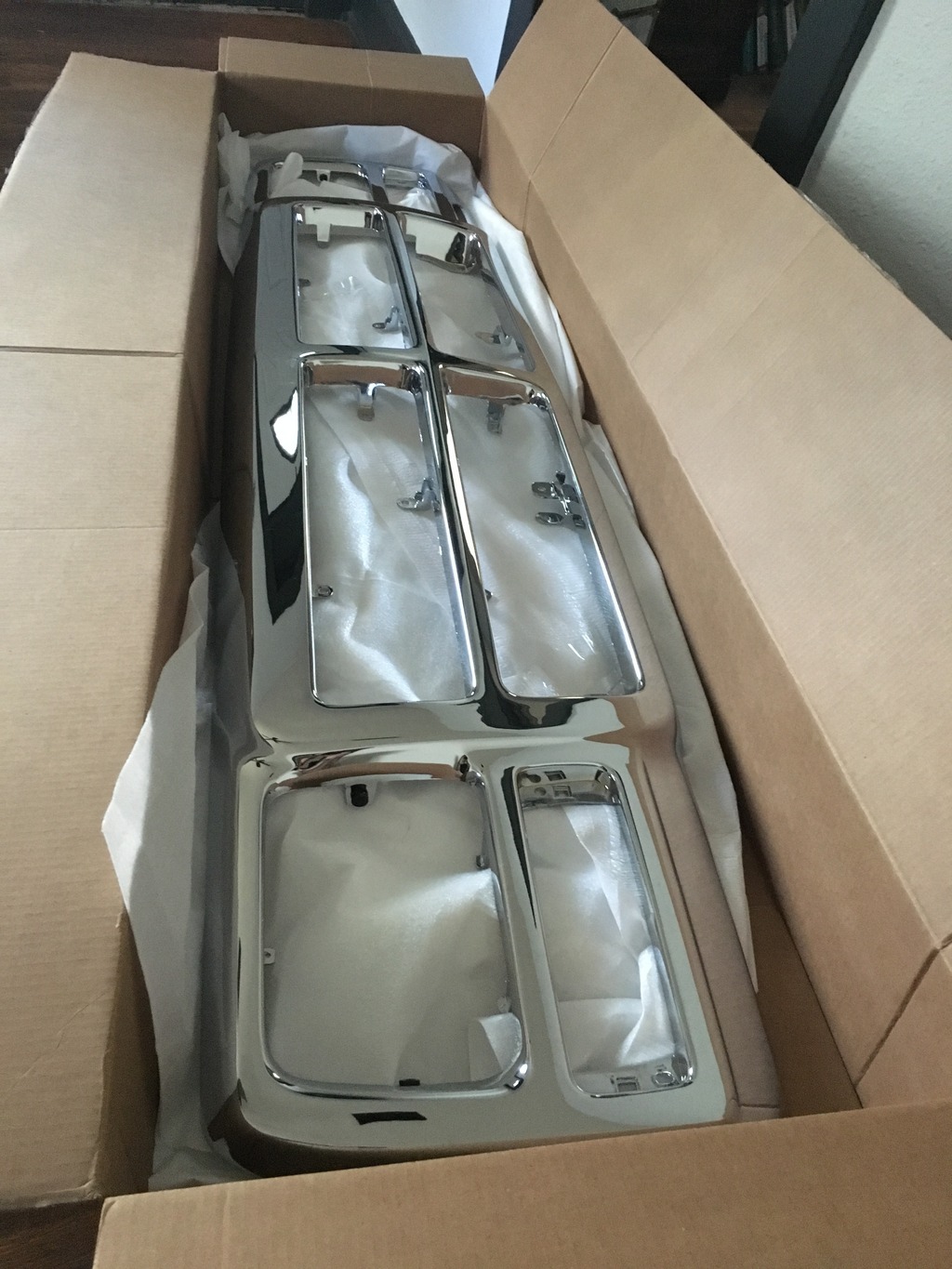

In other news, Christmas in February today! I got the insurance check for the fender bender I was in so I started ordering the stuff to fix the front end. New grille, turn signals, and side marker lights. Already have a replacement step bumper. So next week I'll be pulling the front end off, finally installing the power stroke IC, and these shiny new parts

Pretty Chrome thingy above......

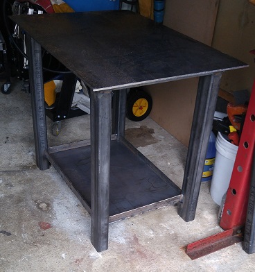

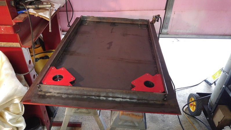

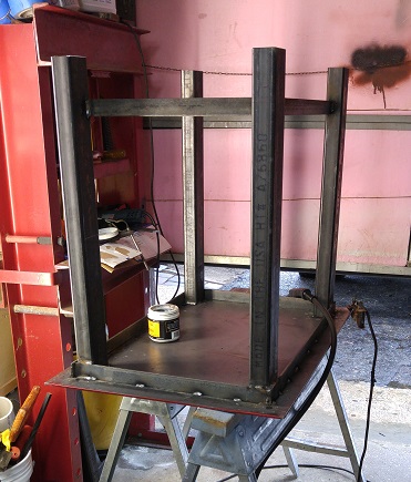

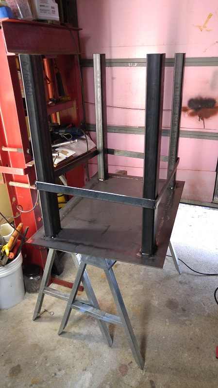

Worked on my latest project. Built myself a little welding / work bench. Wanted it HD, so everything is 1/4" steel. The legs are 3/16 x 2 x 3 tube. Weighs somewhere about 200 or so. should be good to do some welding / fixing of my Brick's parts when they go bad.
Again...
Will finish up the welding when the weather is a little nicer. It was so damp out today that the metal was sweating and causing the welds to goober up a bit. I think I'll let it rust and look old school
