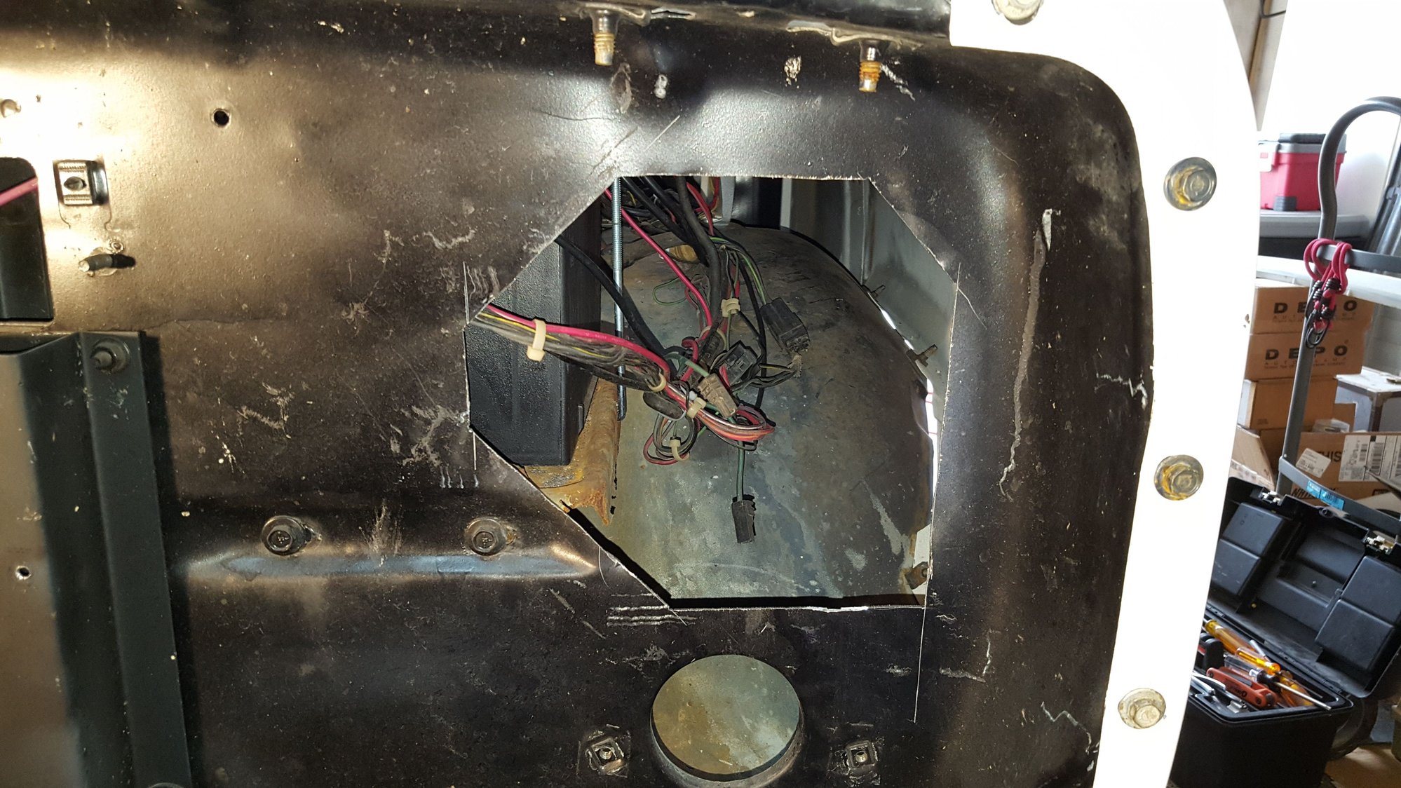

I started by removing the headlight and the adjustable holder. Then I marked the base for cutting. If you use a plasma cutter or a torch be sure to protect the wiring behind it with a fiberglass mat or something non-flammable.

I used a jigsaw to cut out the base but I still hit the battery pan with it. There wasn't anything to hit on the right side.
I then cut a piece of 16 gauge sheet to fit the hole and welded it in. This left a nice flat place to attach the headlight in the new position.
