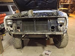

Another -20F* morning to high of -5 day. I am not like TC I wore flannel lined Carhartt pants.
After days of working to get other people's plow trucks back on the road, I actually got a few hours uninterrupted to work on Poncho.
The HX-35 turbo is installed and oil lines in place. I got the '94-'97 style intercooler mounted where I want it so I could test fit and trim a tiny bit of the lower valance panel for proper clearance. The grille will fit with very minor trimming for the lower and outer most screw mounts where it attaches to the lower valance. The secondary hood latch with need to be trimmed, cut down and welded up too make it what I want.

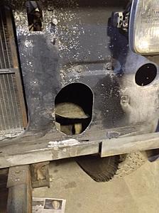

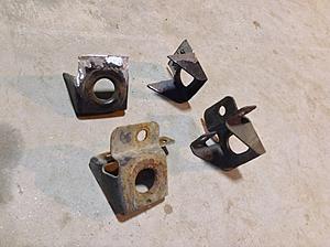

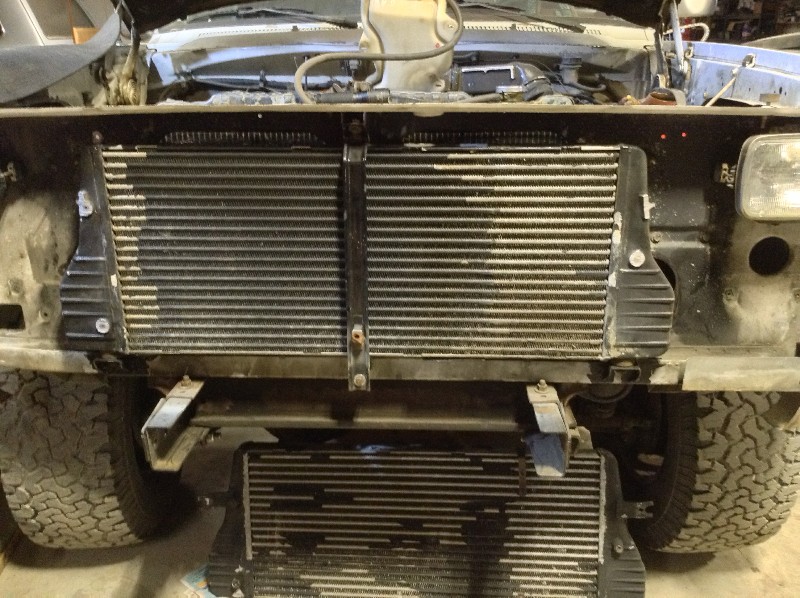

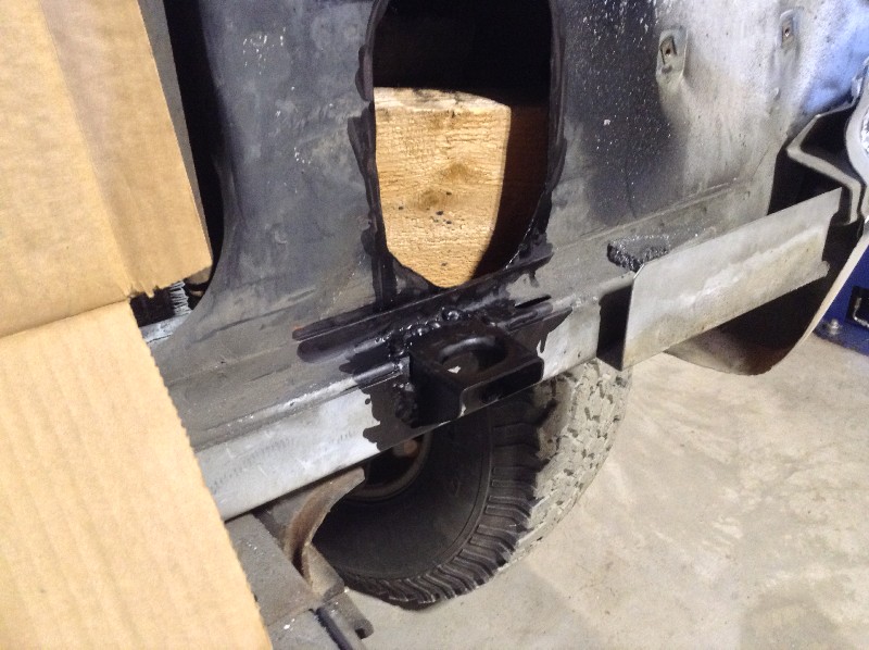

We made some head way yesterday.
We got the core support and valance panel, dabbed with paint and the front end all re-installed. We even figured out a way to use a '92-'93 style center core support brace on the earlier core support.
The '92-'93 center brace left just enough space for the 2nd gen I/C. We installed the center brace with two 2nd gen Radiator bushings and a few 2nd G. fender spacer washers to make up for the missing bracket on the bottom that the earlier core support doesn't have. I bolted it up on top like factory with one extra fender spacer washer.
Char. was in charge of finding the right length and thread pitch bolt for the bottom brace bolt. I armed her with the thread pitch tool out of the tap and die set and set her loose on the misc bolt box. She then ran a tap into it to clean it up, before install.
I used two more 2nd gen radiator bushings for the upper mount on the I/C. Char. pried out the inner metal bushing so I could grind it down a 1/8 to get the I/C at just the right place and give me just a little more clearance for the core support center brace.
I used 2nd gen radiator bolts to bolt it up on top using the mounting holes on the 2nd gen I/C.
I sent some pictures to T-Man who might find the time to post some of them up for you DTR'er to see.
Augie, I see no way to not trim down the secondary hood latch.
I have the I/C mounted as low as possible. The back of the outlet tubes on the I/C almost touch the inner fender now. I actually spaced it up 1/8 inch extra on a spare rubber bushing to add a little more inner fender clearance so the boots don't rub on it.
No little Mopar tech. helper today... Just me and the dogs are headed out the shop to see what we can come up with for I/C tubes. That is after we stoke up the stove. I has warmed up to a -18F* morning here up after about a week of -20 mornings.
