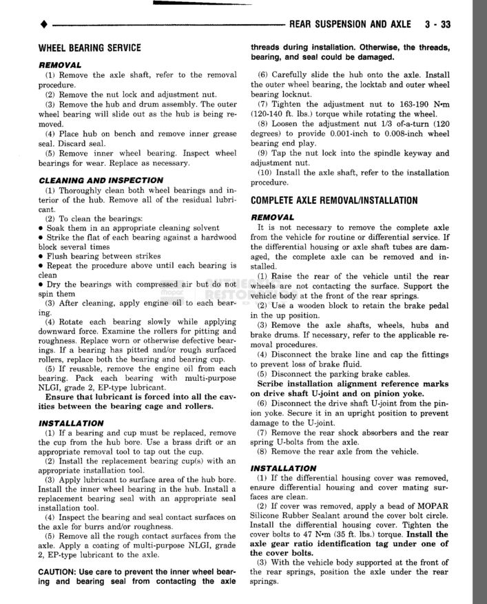

Maybe we can find someone who knows how to obtain Cab mount bushings.....
