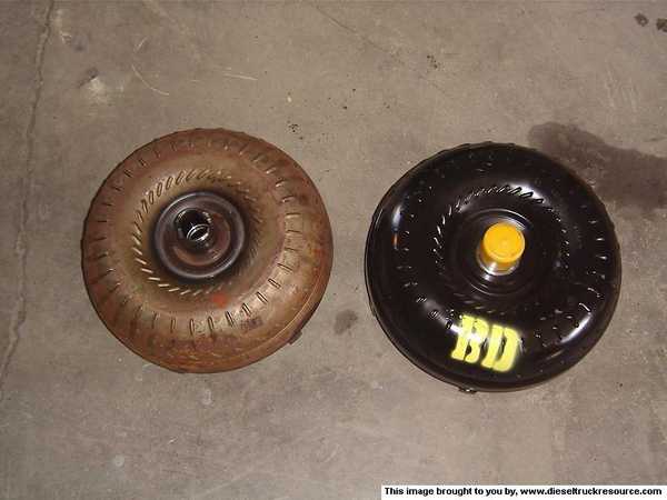

Okay, the job's pretty well finished.
I know this is old ground for a lot of people, but it was the first time for me. There were a number of mistakes I made that cost me a lot of grief.
this worked well and allowed me to move the truck once the guts had been removed.
the BD torque converter uses oem housing.
[IMG]
[IMG]

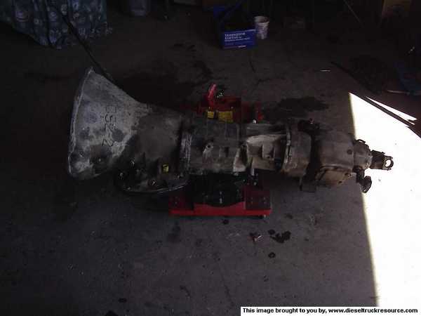

One of the biggest problems I had was trying to get the assembly out of the truck in the first place. I had a real fight to get clear of the torque converter because of interference with the cab. next time I'm going to take the whole works in one piece, Including the torque converter. as you can see in the picture, the assembly balances well with the t/q in place, in fact, in this picture it was just slightly light at the t/q end, but I had no stability problems. I could have probably put a couple more litres of fluid in the t/q and had it balance perfectly. also, with this arrangement you get a couple of extra inches of clearance because of the jack sitting under the o/d rather than the oil pan. it worked really good. it took about 4 hours total to put it back in, but most of that was the small stuff.

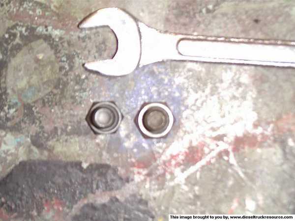

the t/q bolts supplied from BD didnt look as good as the originals, which I cleaned up and reused.

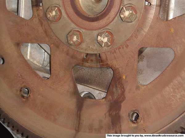

I was surprised how easy it was to spin the flex plate for bolting up the t/q.
all thats left is to drill and tap the inspection cover holes for 1/4 bolts and that should be the end of it... for now
