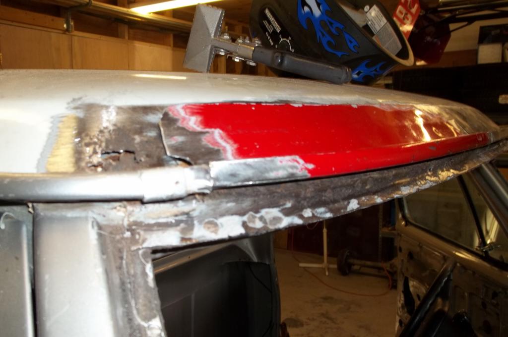

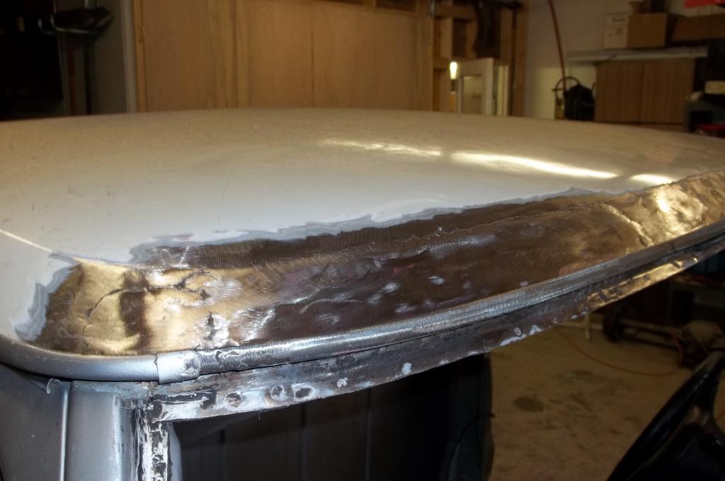

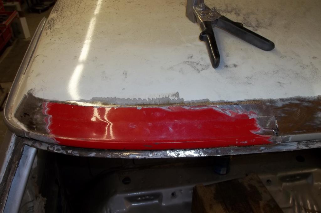

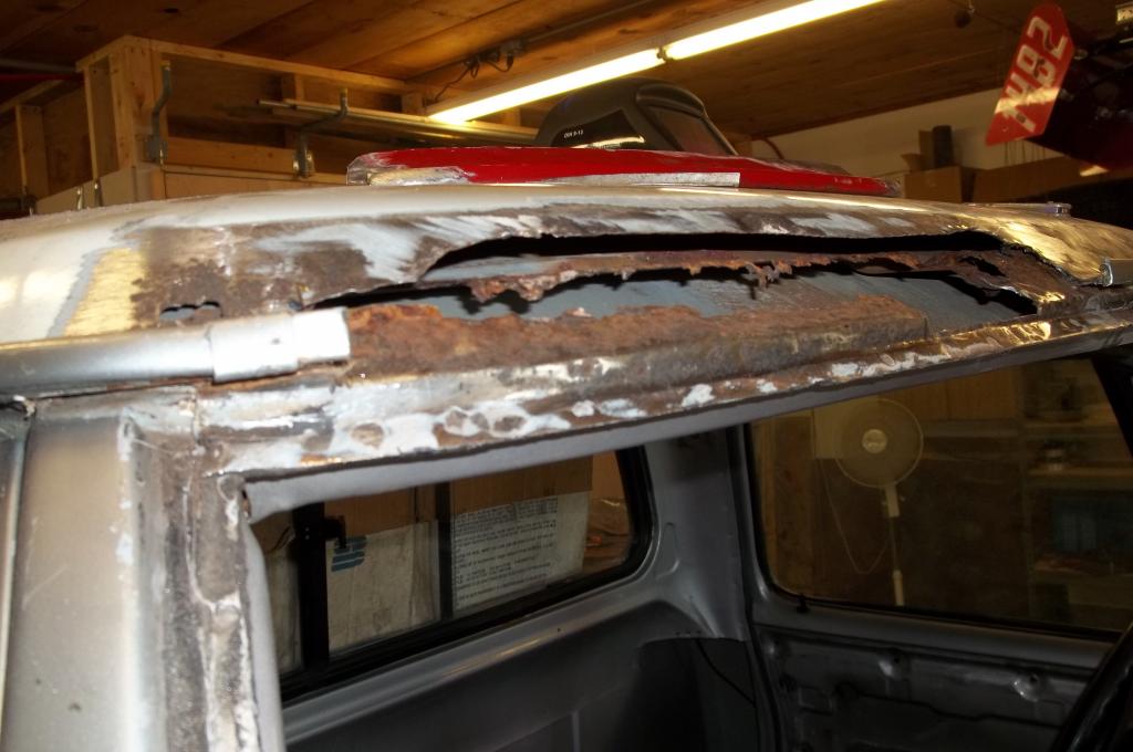

this is what i did.next time i think i will put a whole roof on,an older style one like the club cabs have (don't know when they changed over).they don't seem to rust like the newer ones.
