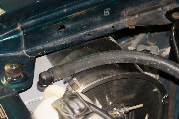

OK, so the original point of this thread was to vent excess blow-by so as to reduce/stop oil being pushed out seals and the single OEM vent by being overwhelmed when running WOT. That goal has been met.
I added the 24v type crank-case vent (it goes where our OEM engine oil fill tube is on the gear case cover).
I also added two of the valve-cover vent assemblies. The OEM vent and the 24v vent are connected to one another and vent under the driver's side cab. I had the two valve-cover vents connected to one another with that hose paralleling the other to under the cab . . .
Again, at idle, my heap presents with, . . . on a cold day, . . . a visibly noticeable amount of vapors (steam) out the two vent hoses.
It "Stanks"!
The way I see things with my heap, the vast majority of vapors come from the OEM and 24v vents as they offer the least amount of resistance to flow. The OEM vent sees the flow at the lifter-valley and the 24v vent sees the flow through the gear-case. On the other hand, the two valve-cover vents see the same flow as that in the lifter-valley, but it has to flow past the push-rods to get to the valve-covers.
OK, fine . . .
At idle, the subtle low pressure area in the cold-air box should pull in a decent amount of the vapors. Not all of it, but enough to greatly reduce the "Dang! Who farted?" smell.
Anyhoot, I'm bored tonight and waiting on transmission valve-body stuff so . . . .
I re-oriented the two valve-cover vents so they'd point toward the engine's air filter box. I then whittled out a piece of pipe that connects the two valve-cover vents and have it terminating above the alternator's top bracket .. .
From there, I ran the hose over to the "Stock-Pot Cold-Air Box". I connected the hose with a nice 90* fitting into a standard PCV valve grommet . . .
As I said earlier, the majority of the vapors go out the other vent hose. As such, it presents as being "Wet" with oil inside. The valve-cover vent tube does not. Even with a good number of full-throttle blasts. As such, I don't expect there to be an issue with an oily mess in the filter box.
With the way I have it plumbed now, there is still a small amount of vapors being emitted from the hose under the cab, but no where near the original amount.
Kewl.
