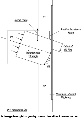

They way a piston ring typically works is by taking advantage of the pressures developed with the piston's movement in the cylinder. Said pressure gets in between the ring and the bottom of it's groove in the piston. The way the ring sits in the groove with the piston's upward travel results in the gas pressure pushing the ring outward, against the cylinder wall. That is basically what make it work. The greater the pressure, the greater the force exerted on the ring.
The effective force is directly related to the pressure difference between the high-pressure side (P1 shown below), and the low-pressure side (P2 as shown below) of the ring. So not only increasing the high-pressure side makes a better seal. Reducing the pressure on the low-pressure side of the ring is just as effective. A good illustration of this applied in the automotive industry are the Big-Dawg racers who run a vacuum pump on the crankcase.

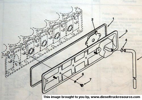

The OEM 12 valve CTD is vented through the block's lifter valley cover. The vent itself amounts to a 3/4" pipe sticking out the side of the cover. Any entrained oil mist is (hopefully) caught by simple baffling (Part no2).

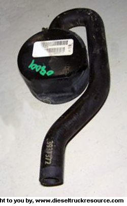

Some simply add a common Universal type Breather Assembly to the valve cover(s) or perhaps the OEM 1st Gen oil fill tube.

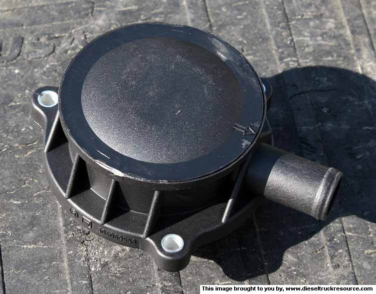

Dodge/Cummins went to a different method with the 24 valve engines. It works better in catching the oil mist as compared to the earlier version (There's folks who might debate that!) by using a strainer much like the scouring pad.
Dodge/Cummins moved the 1st Gen's oil fill from the front gear cover to the valve cover and placed the new crankcase vent where the oil fill had been.
It appears that the new design is not 100% effective at catching all the oil mist as the standard OEM install includes a bottle to catch the big stuff that makes it out. Periodic/routine maintenance has one empty the bottle when needed.
Still, the newer design vent can be combined with the original for a great improvement over stock capabilities.

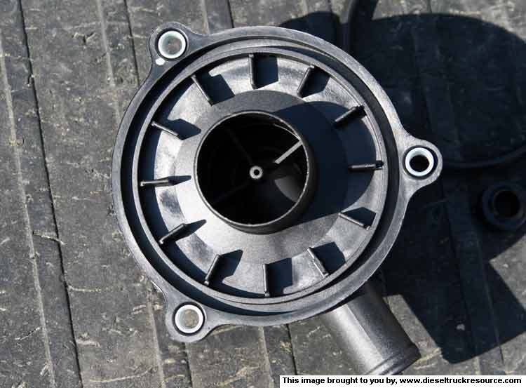

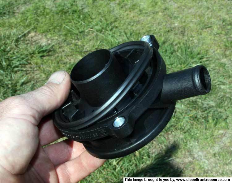

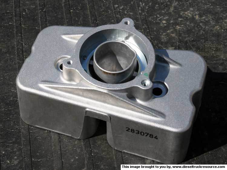

Another option is to install the crankcase vent as is used in Case/International tractor (Cummins) engines. In this application, the vent/breather is mounted to the top of two valve covers.
The associated Breather assembly bolts to the top of the cover.

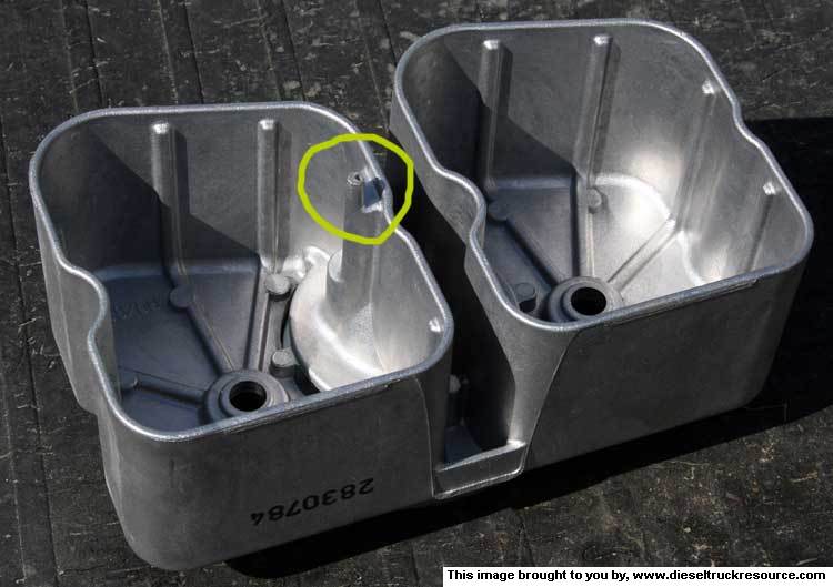

The way the cover and breather are made, the flow of oily gases must flow through multiple turns on it's way out. Impingement of the oil occurs all the way. The oil collected by the baffles of the breather are drained through that little pipe seen in the center . . . .
It collects with the oil caught by the initial baffles of the cover, and are drained back into the engine through a pipe in the bottom of the cover . . .

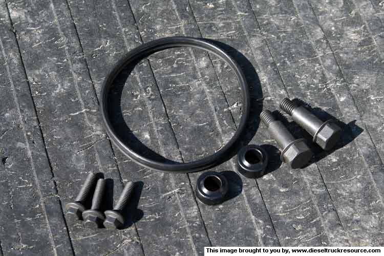

If you go this route, in addition to the cover and breather, you'll need some additional hardware to nail it all together.
NOTE: You 1st Gen folks can use the original OEM valve cover bolts as they are correct for this application. It's my understanding the 2nd Gen 12v crowd may have different OEM bolts that don't fit quite right. It seems they can get by with adding the appropriate washer. You'll need three bolts and an O-ring type seal for the breather, and two bolts with seals for the dual cover. The stock/OEM valve cover gaskets normally used seal the cover to the head.
The assembly is straight forward. Simply press the O-ring into the groove on the underside of the breather. You'll notice in the following image, the bolt hole seen in the upper/right appears to have some pipe sticking out compared to the others. It in fact does and I assume it's for the purpose of installing the thing with the outlet correctly oriented in relation to the engine. You can swap that thing to a different hole if you want to have the outlet point toward the front/left or the rear/left (default) of the engine. Pending where you place the cover, you can orient the outlet so as to point directly to the right/center side of the engine provided it doesn't bump the air intake horn.
Also note that when using the dual version, you'll need to keep the injector lines in mind as where they pass from the injector pump over to the injectors, there may not be enough room for the bridge of the dual cover to fit over them.

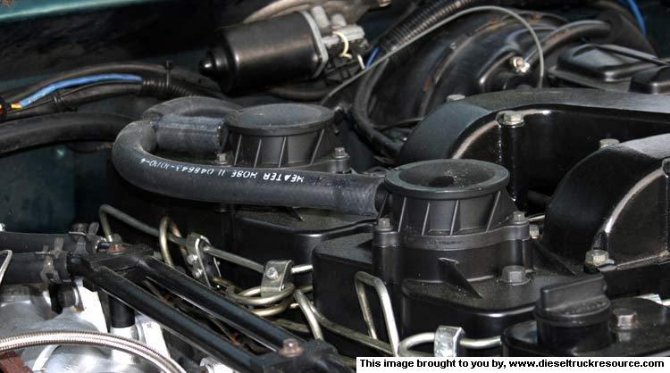

As usual, I went nuts and initially started with supplementing the OEM side cover vent with that from the 24v. I then added two the the dual cover vents to that.
I connected the 24v vent with the OEM vent using 3/4" hose, wyeing the two together and on out. The two dual valve cover vents connect to a second 3/4" hose.

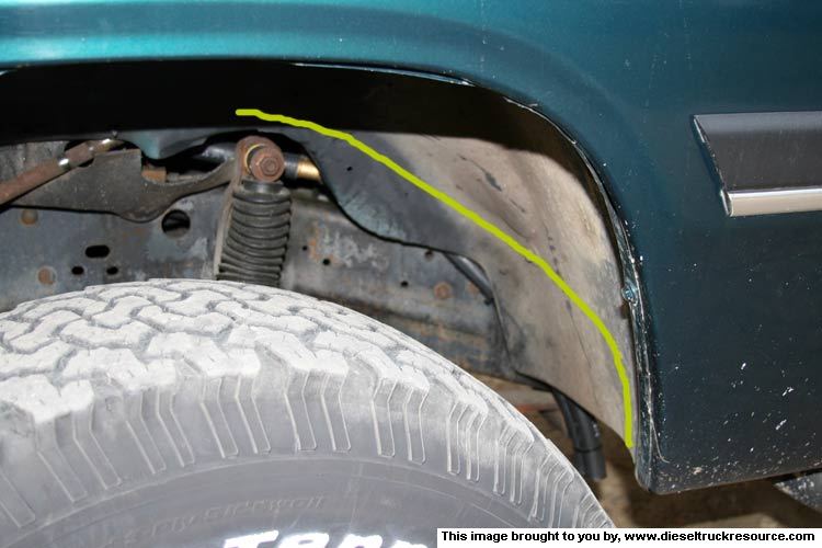

The two hoses run down the driver's side of the engine, above and outside of the frame rail there, and on to just inside and behind the driver's front tire.

I know, perhaps it's a bit much, but I expect the blow-by to increase as I plan on running with a higher boost figure in the not too far future. With that, I don't expect to have any oil leaks as a result of excessive crankcase pressures. We'll see.
Still, at this point, things work well enough that it appears that coming from the two vent pipes has a LOT less oil entrained with it. I look forward to a cleaner underside. I'm even considering routing the vent gases to the engine air filter box. Maybe.
If you're interested, the 24v crankcase vent can often be found on E-bay. NOTE, you 1st Gen folks will need to relocated your oil fill though. I simply cut the top of the OEM fill tube, drilled the right sized hole in the front valve cover and epoxied it there.
If you want to run the Case tractor vent, you'll need:
1 - Dual Cover P/N 2830784
1 - Breather P/N 2852531
1 - O-ring Seal P/N 2852028
3 - Cap-Screws for the breather P/N 4899092
2 - Valve Cover Bolts 4895214 (1st Gen use OEM)
2 - Valve Cover Bolt Seals P/N 3935449
NOTE: the above part numbers are a combination of Case IH & Cummins part numbers as used by these folks http://www.messicks.com/default.aspx. Doing a search of these forums as well as the lessor Cummins diesel websites will present with similar numbers.
