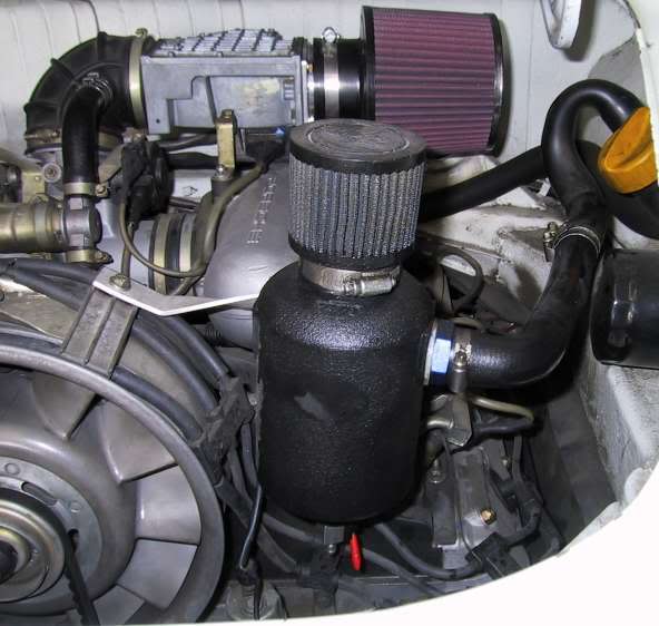

Originally Posted by 'Mad Max'
copy. I am planning to plumb the end of the vent into the air box but not directly into the turbo inlet tube itself. This way it'll be vented to the outside air and the engine intake should draw the smelly vapors enough to make it a non-issue.....should. Plus if the exit for the vent is on the outside of the filter then the filter should make for an effective barrier to whatever oil particles manage to make their way to the exit......should.
I can control the oily mess in the air box - it's going to be a fabbed piece under the p-side fender with an external louvered inlet - military style. It'll have a water (and oil) drain in case it rains, etc, and should be a perfect intake port and engine breather vent.
Thanks for the discussions.
It would not be a good idea to vent the crank case into the inlet, either before the filter or after. The oil mist will coat the inside of your intercooler which has an insulating affect (oil traps heat energy) making your heat exchanger much less efficient. It will also coat the impeller with crud. The second issue is a high boost Cummins has a ton of blowby, and that much oil in your inlet could cause pre-ignition which would be very bad.
I vent mine with a catch can like this: Name:  breather-tank-31081473484.jpg
