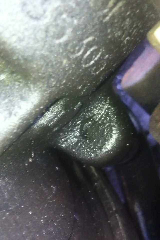

Thanks for all the replies guys. I must say I am very overall pleased with DTR. I've been on CumminsForum for about 4 1/2 years. It's a good forum but I definitely find DTR a lot more informative. Also a lot more write ups on here compared to CF!
Anyway, back to the topic... So I took a few pictures so y'all could see. Bear with me as I try to upload them lol

Both top & bottom pictures are of the bolt closest to passenger fender.

& here is the other bolt(closest to manifold).

Bearkiller's plan of attack sounds right on.
