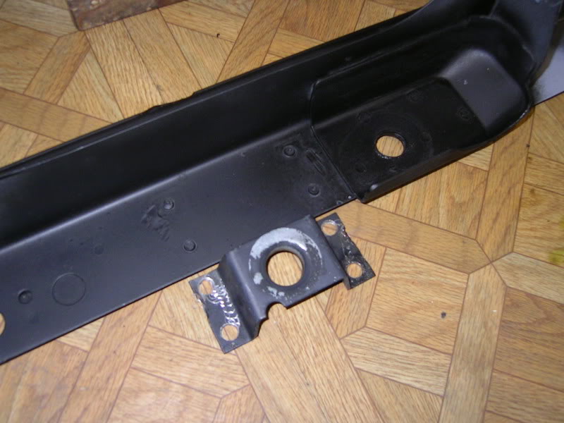

First I removed the lower rad support brackets...I cut the two welds on either side of each bracket, then used a punch to dimple the center of each spot weld and used my spot weld cutter to free them up.

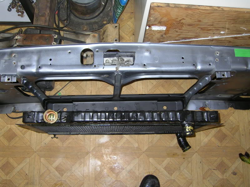

Then tried to fit the rad into the support, it was tight on the lower corners and sides.

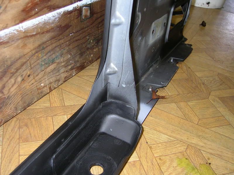

So I figured I needed to trim the lower dish shaped bracket and the little triangular protrusions on the upper supports.

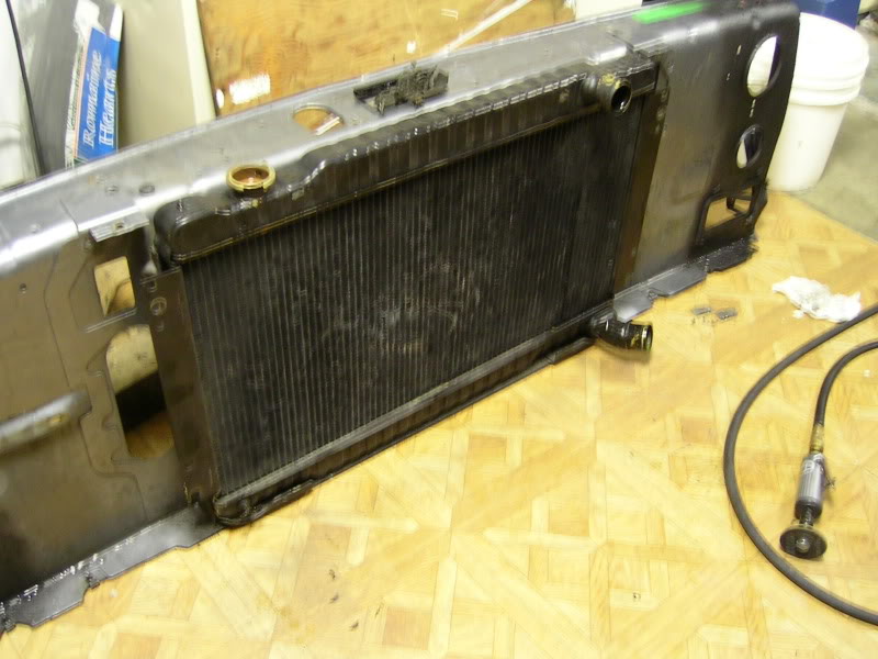

Did this and trial fitted again.....it fell into place....well it's tight but fits not too bad.
Will have to fab up some custom brackets for holding it into place...but won't do that until it's in the truck and hooked up to the rad hoses.
Old Nov 11, 2011 | 10:58 PM
I know I'll have to trim the side brackets on the rad once I get around to installing my PS IC, but that's nothing too bad.
