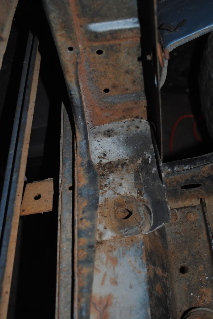

Here is a pic of what i got broken. See the crack along the hole for the body mounts. Should i weld it or is this something that will have to be replaced when an intercooler goes in?
Old Oct 17, 2010 | 09:36 PM
Thiss's Avatar
Posts: 416
Likes: 7
From: Monmouth, Oregon
I am bumping this because i plan to gt to work on it tomorrow and would like to know what to do.
1. Weld it up and replace body mount
2. Replace body mount for know and fix later with from IC truck when IC goes into
Thanks for taking a look folks.
Old Oct 17, 2010 | 09:42 PM
JustRamIt91's Avatar
Joined: Oct 2009
Posts: 1,830
If you don't have a spare, i would just weld it up, grind it flat and paint.
Drilling out welds and trying to get parts out is tough sometimes. i would probably still weld it up if i had a spare sitting around, in case my rear body mount went bad ;-) i'd still have it.
Old Oct 18, 2010 | 07:06 AM
Trebor's Avatar
Posts: 1,167
From: SW Pennsylvania - Greene County
You need to find out why it cracked there. There may be some substructure issues going on. I believe there are two substructure layers below the crack. If they are rotted out there is a good chance it will crack again. That area rots out here in the rust belt. I have one that looked good in the truck until I removed the radiator only to see half of the top layer was completely rusted away.
Old Oct 18, 2010 | 01:27 PM
Thiss's Avatar
Posts: 416
Likes: 7
I will check more for rot, however, I am currently deducing my grandfather chasing antelope out in the desert and jumping it a few times is the reason for the break.

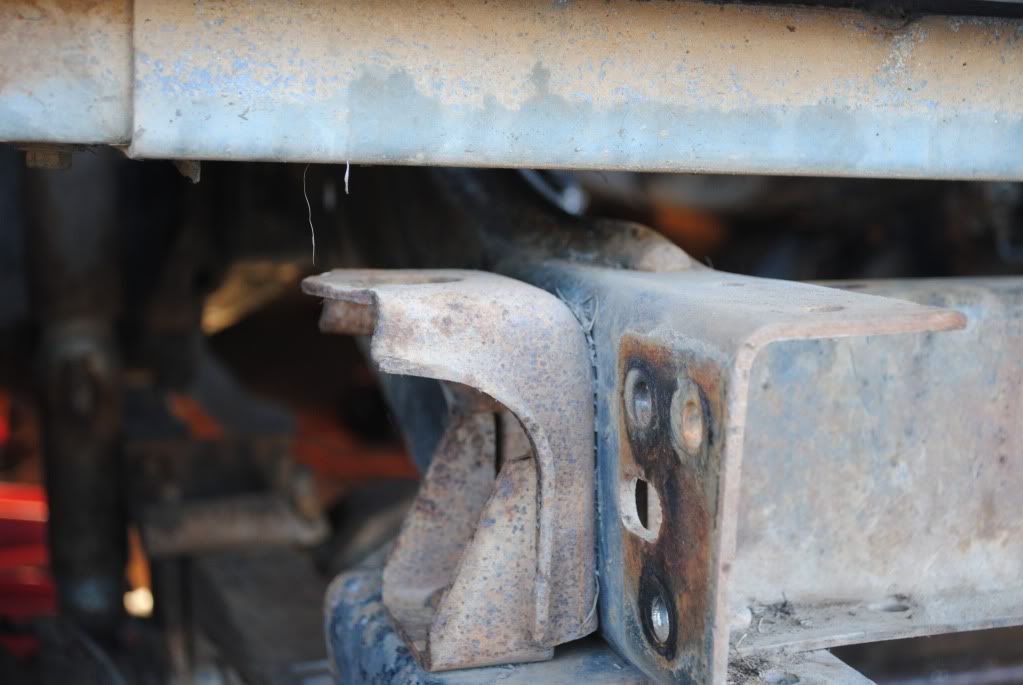

Is this right? Why is the front body mount not using the perch? You can see in one of the pics that that the mount perch isn't used at all for the radiator supports. What's up with this? There are no signs of alterations or fab work, it looks stock.
Old Oct 18, 2010 | 08:43 PM
Trooperthorn's Avatar
Posts: 890
From: Salem, OR
That bracket is normally vacant. On 4x4s anyway. Don't know why.
Old Oct 18, 2010 | 09:52 PM
Thiss's Avatar
Posts: 416
Likes: 7
I am ignorant. The 91.5 is set up the same way.
