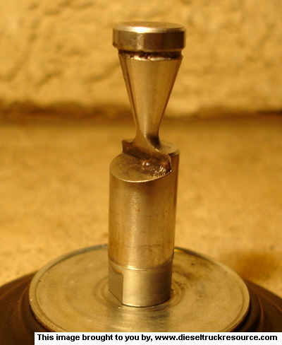

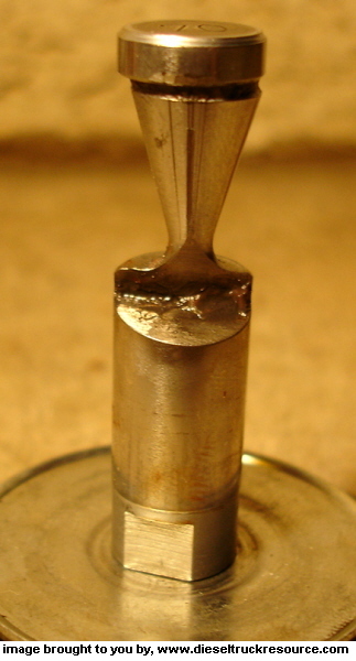

Are you talking about the one in my sig? A previous owner did a hack job on mine, it's a very non-traditional grind. The profile is stock, but the ramp was extended up past where the fuel pin would normally ride, and the nylon spacer washer that limits travel was removed.

Wink Pics from 3 angles - ask and ye shall receive

thank you for the great pictures of the fuel pin. I have an extra pin, so I think I will give it a try.

I think it's a good setup for a truck with big injectors. When you have POD's or similar your focus changes from trying to get a lot of fuel to get the turbo spooled to trying to delay the fuel until the turbo spools.
Lorydrell, for your stock truck a more traditional grind (more fuel sooner) would be a better setup.

Hey Dave, do you think the cone bottoms out before the pin can ride the entire profile...even without the washer?

Yes. You can't see the wear mark real well in the pic, but it only goes to about even with the "step" where the stock profile starts.
