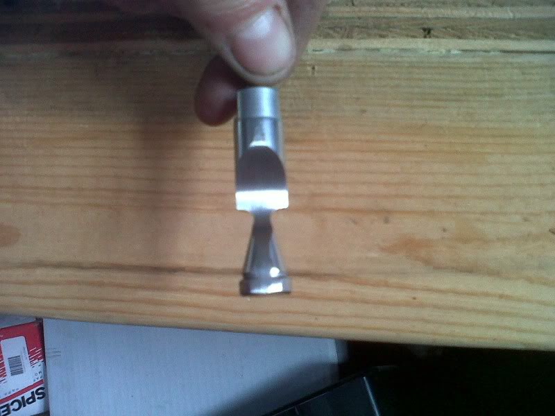

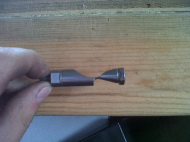

this is a picture of my pin that achieved it on the shallow side. It's a pretty conservative ramp to start which is nice for not blowing gobs of smoke at low/no boost takeoff. It's sort of hard to explain but in order to do it properly you have to take the whole pump top off. You then remove the pin and grind some of the pin. slide it in place to the bottom of it's bore as though you were getting full afc travel and move the AFC lever and see if the little part of the afc lever is bottoming out on the housing where it pushes on the guide pin. If it's not, grind more on the fuel pin, then check again, etc etc. Do that until you're just barely getting full travel. I used grease on the fuel pin to see where the guide pin was sliding on the fuel pin so I knew where to grind. I also kept the spring in place so I could make sure the starwheel wasn't too high limiting the fuel pin travel due to coil bind with the spring.
Hopefully that makes sense...
And it doesn't look like there is much material left of the fuel pin and that it might break, but the picture is sort of deceiving, there is plenty of metal left to hold it together. Just don't drop the pin on the conrete floor or it could actually break.

Old Dec 19, 2014 | 01:12 AM
Thanks for the pics and explanation Rick...Muchly appreciated!!
I have 3 or 4 stock pins around I can play with....so might try this in the near future. What did you use for grinding?

I have to say Rick, that grind does look good.
Brian, if I recall correctly, the guide pins are not all the same length. If that's the case, you would want to use the actual top cover & AFC assembly that you are going to run as the gauge for the grind.
