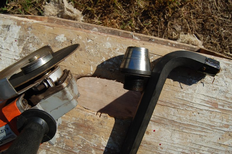

Just a comment, I got my king pin kit from Quad4x4, its very complete, I also added their 7/8" hex socket as seen in the picture this with a 3/4" breaker bar and some pipe made short work of the king pin removal. Got my crossover steer arm and drop steer arm from Offroad design.

Another way to do it without heat (which I think works even better than heat) is to use a grinding disk and cut a small groove around the outside of the king pin and it pulls right out since you have reduced the surface tension of the king pin:

That cutting the king pin near the base is some good advice!
Same basic thing I do when removing bearing from a pressed axle or something. Cut almost the whole way through, then tap with a chisel and they pop out.
