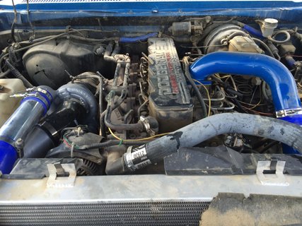

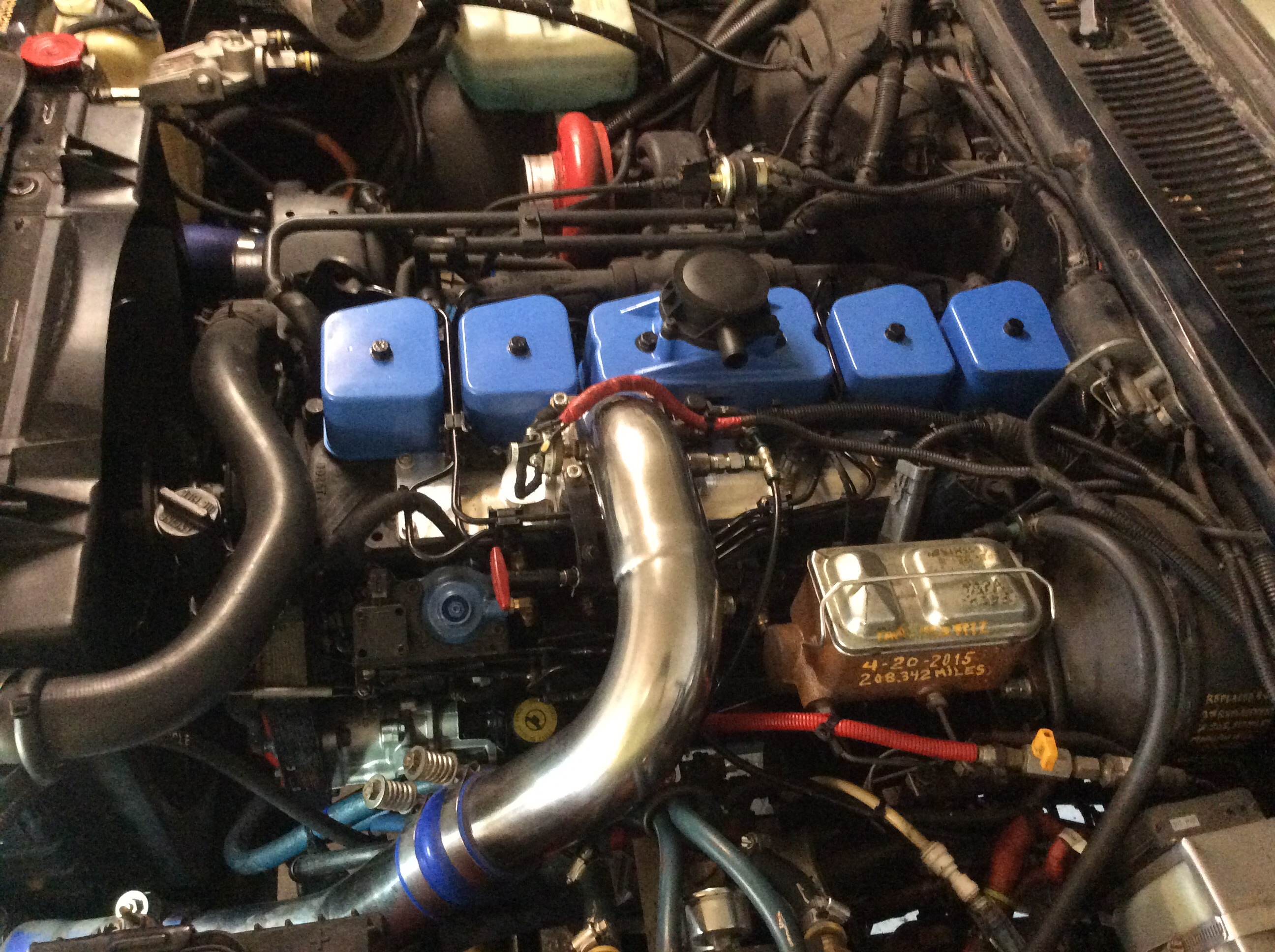

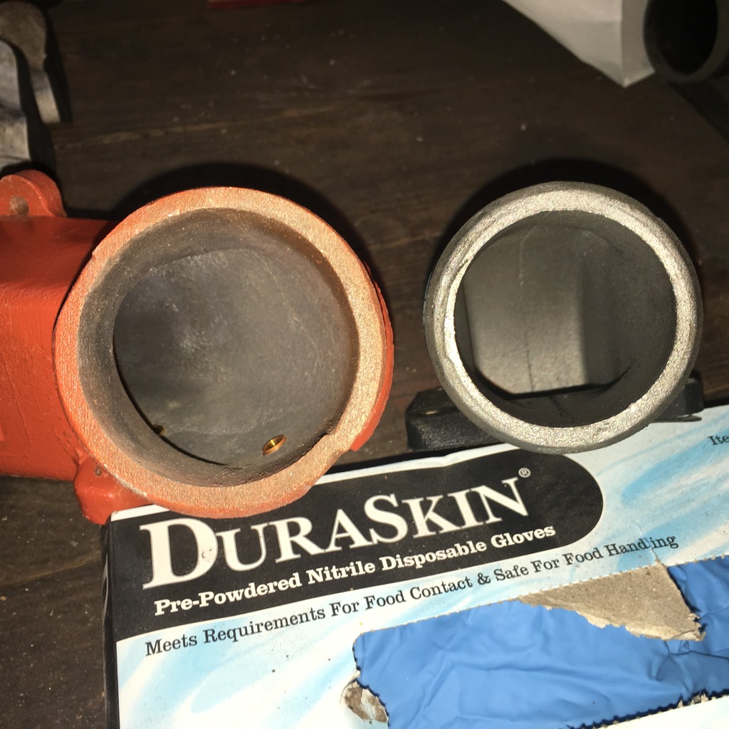

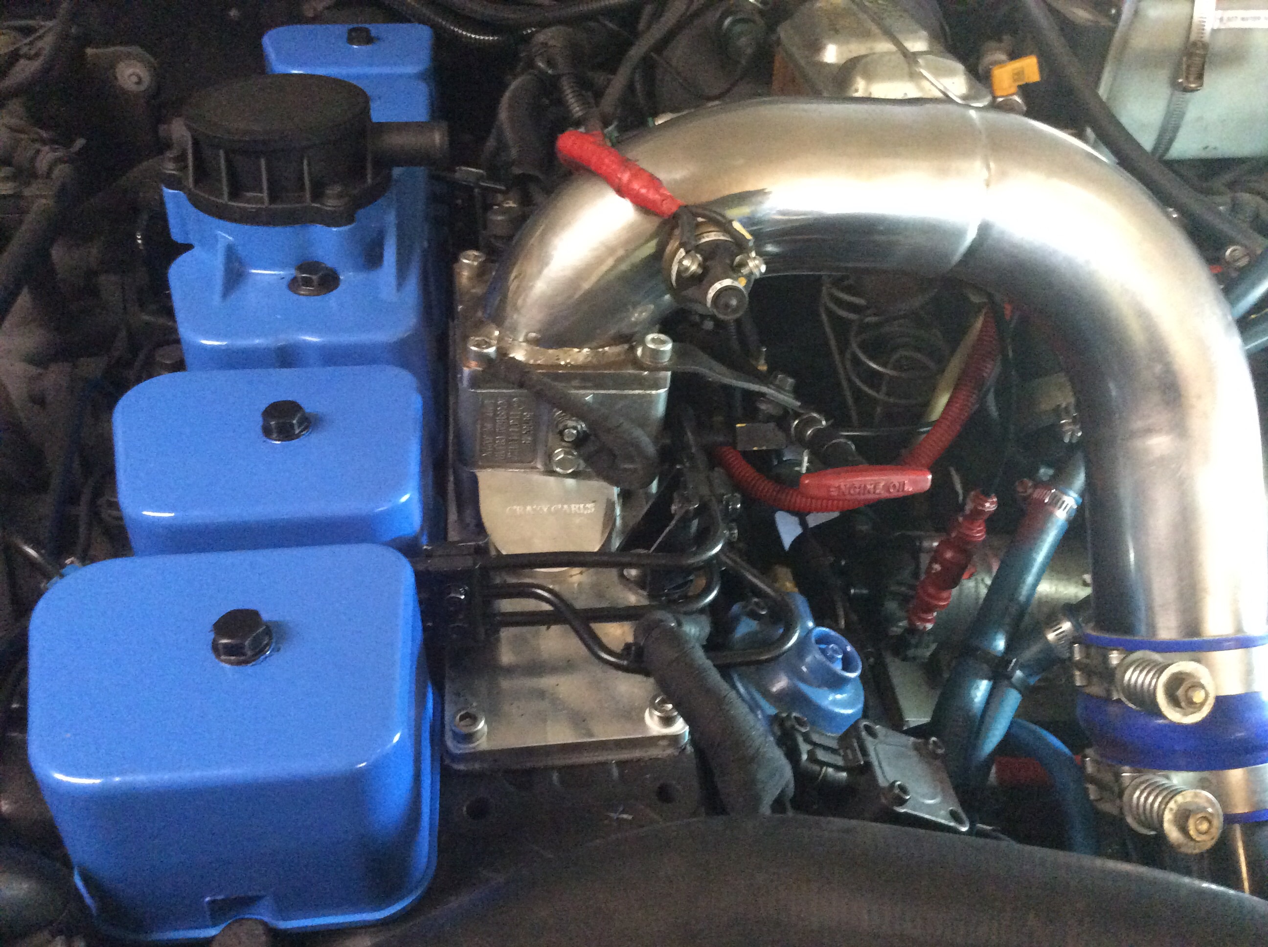

some of the "pusher" style intake horns will and some won't, from what i've seen reported. as mr.oliver stated, a 2nd gen 24v intake will clear and is used by many. engine ****.

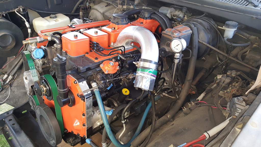

And to piggyback on Hillbilly, here is Tim Wuorlines 3" intake horn, on top of the stock grid heater, which sits on top of Crazy Carl's billet intake plate.
I was originally worried about the clearance because the CC intake plate has a design that adds additional height to allow better airflow passages to the outer cylinders, but the fit up went well.

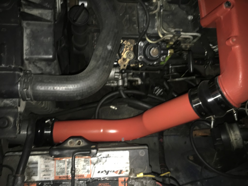

Another view. The CC intake plate is designed specifically for our 1stGens
