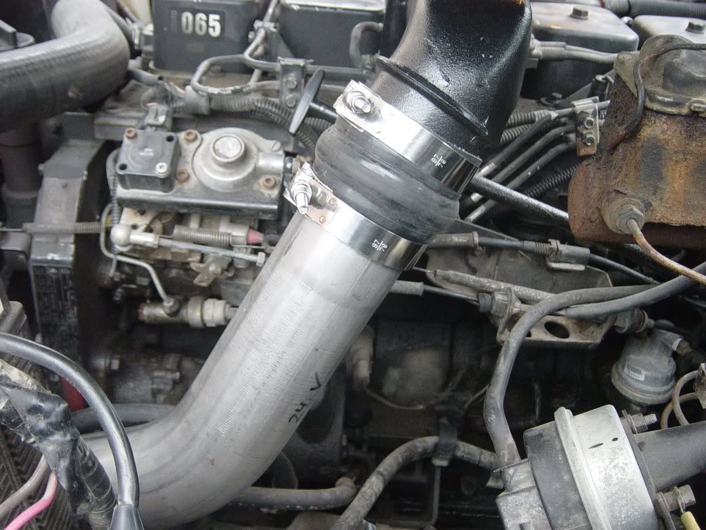

puscher here,pleased

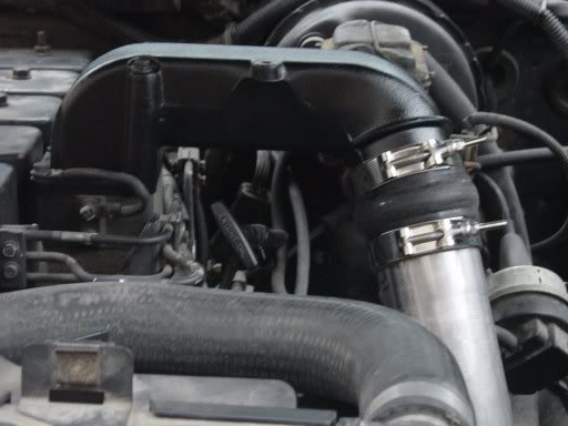

I use a 2nd gen 24 valve air intake horn. I went down to a local muffler shop and had a new IC tube made to fit. Then I threw that new tube on my bead roller and run a couple of beads and threw everything together.
BTW Do not use a air horn off a common rail.
Those air horns are not any better than a 1st gen. They are very restrictive.

Lensguy, did the stock pipe line up?

my truck was non ic. it was a straight shot from the horn to the 2nd gen ic i used. placement of the ic was done per the instructions in the sticky here. hope that helps.
