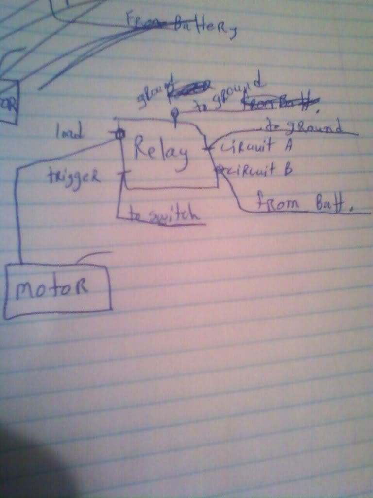

I think you could do it with two relays per door.
On each door-
1 run a lead from the battery
2 cut the wires to the motor. Connect each one to the single-terminal side of its own relay
3 connect the power lead from the battery to the terminal of the relay that the relay switches to when triggered
4 connect the default terminal of the relay to ground, along with the relay's ground terminal
5 connect the wire from the switch to the terminal on the relay that triggers the relay.
Basically, do this with every wire that connects to the window motors.
