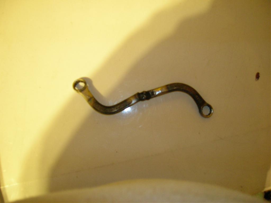

I know that many of you have invented or reinvented a special tool to handle a nagging problem on our first gens at one time or another. How about posting a picture of your handy work with a brief explaination of why it works.
The "s" wrench is for the nuts holding the IP.

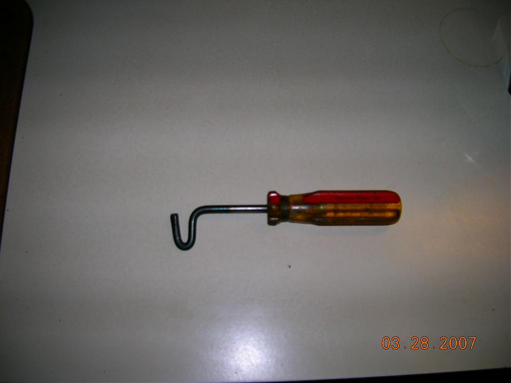

the shepherd's hook is what I came up with to remove and install those pesky brake springs.
Now, let's see that thing from a couple more angles.

Are you using that for the retainer springs or the return springs?
I used it on the finger biting thumb smashing anti religous retainer springs. After I fought them for one afternoon.
You poke the shaft into the coil and lever the spring arm up against the backing plate. WIth one hand mind you. Then you simply slip the "bent nail" onto the spring and gently release the pressure.
